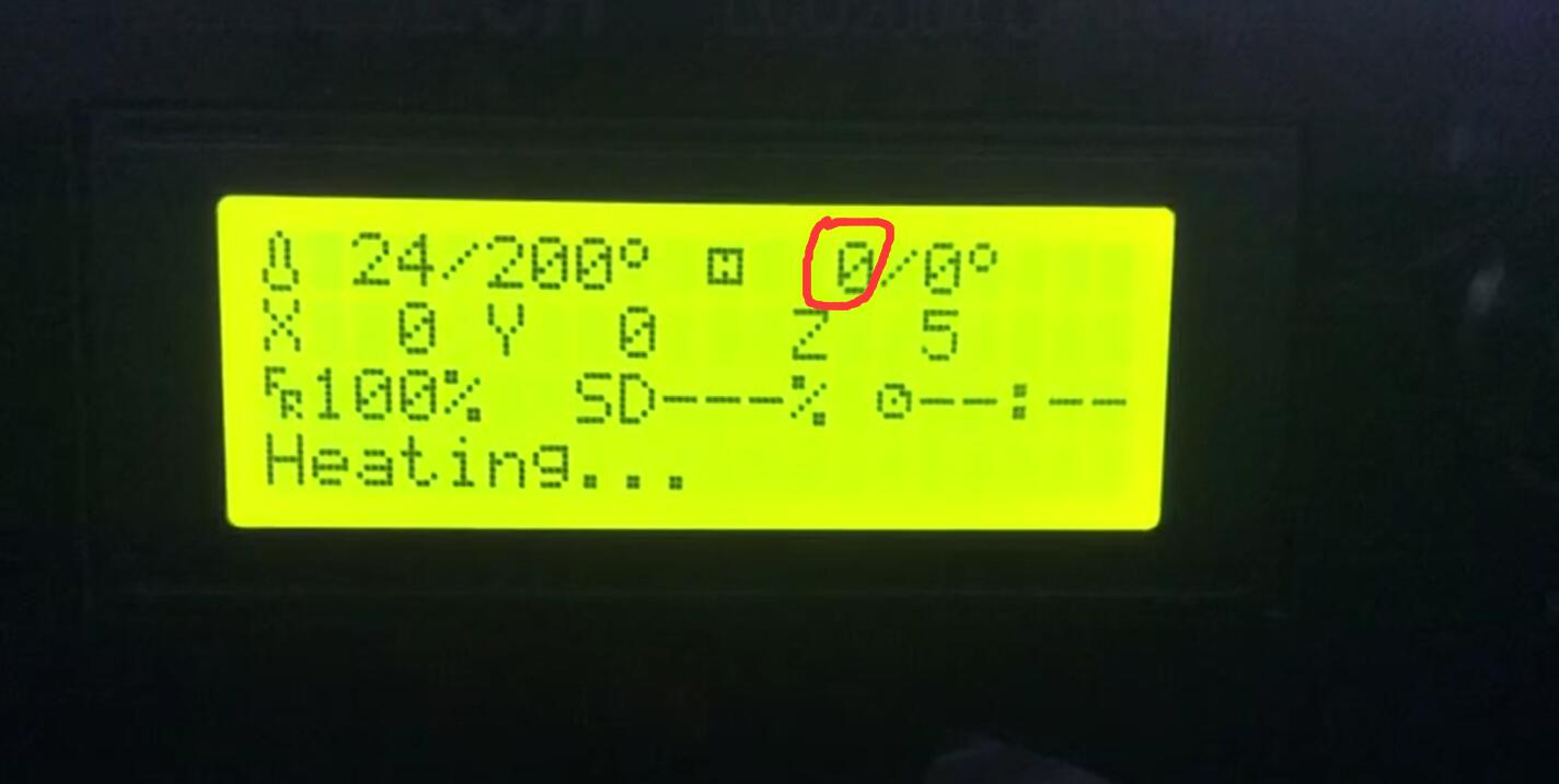

I think you'd better check if there is a open circuit in the circuit related to heatbed's THERMISTOR(wires for the thermistor.),cuz the following LCD pic suggests the heatbed's temp isn't been detected by the motherboard. 3)Hot end and heat bed not heating up

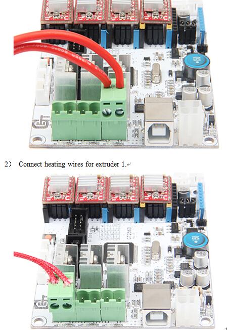

Check if the two heating wires(the heating wire of heat bed and extruder) are correctly connected.

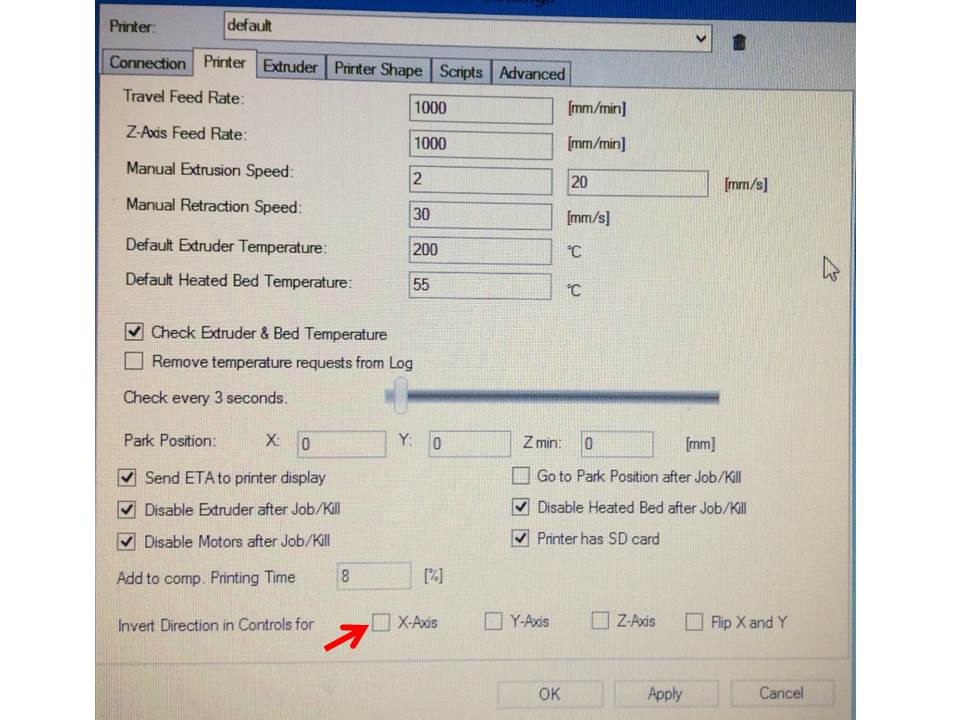

We MAY "store memory" in "control" after modifying the parameter, - after selecting "invert directions in control for x-axis", there is an "Apply" and an "OK" button (does it mean it stored the memory?). Could you please give us more details on how to do it the right way? Is there a way to reset the "default setting" (just in case something has been changed)? I attached the setting seen under "printer". Also, please note that we may have touched the LCD control panel some time during the installation, but after that, we have never used it.

1.About the wrong motor direction,i'm afraid you have to modify it in the firmware,here you can find something useful:
http://www.geeetech.com/forum/viewtopic ... 17&t=17037

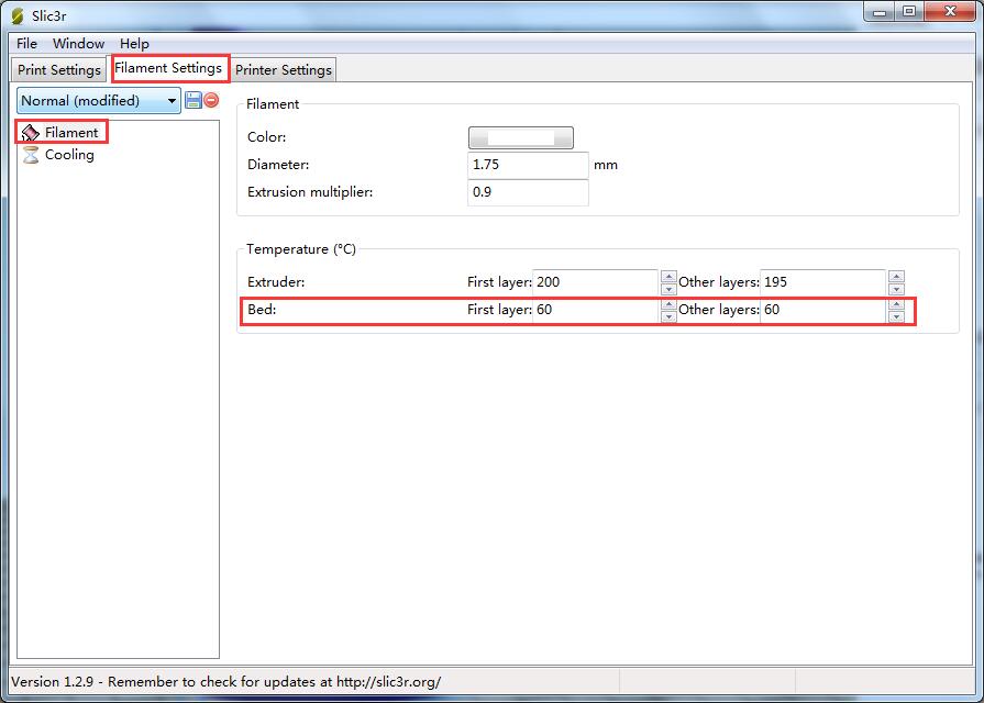

3.About the bed heating,you can set it in slicer settings,which is used in the printing process to make the object to stick to the bed,then it will heat up automatically when you're printing:
