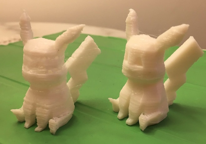

Seem to work fine for me - but now the extruder is missing steps sometimes, but the print is really better
See Picture : pikachu before /after

Seems better now, but i think maybe you have too much pressure, with the piece of paper i have good results, dont missing steps or something.Rege wrote:Hello
