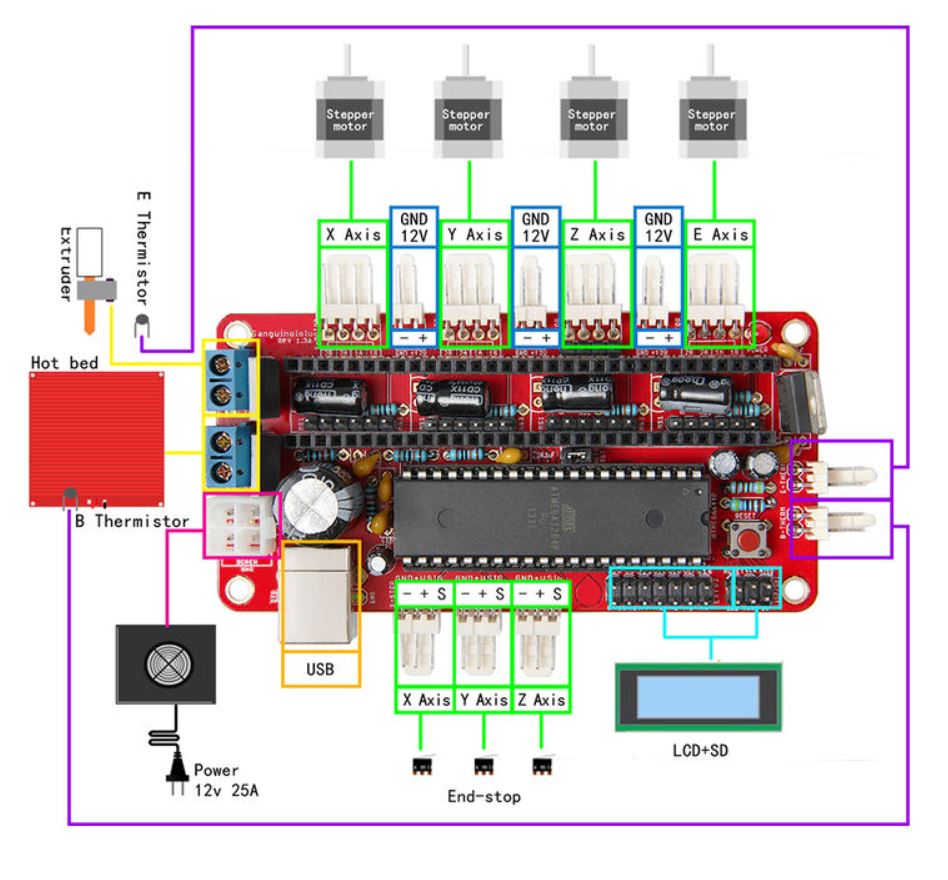

Could it be related to the wiring, particularly the supplied 2 prong extension supplied for the 3 prong extensions for the X Y Z end stop relays ?
These are marked "-" "+" "S" on the Sanguinololu Board diagram below ...
The video looked as if they were attached on "-" & "S" on the video ... but I'm not sure now ???
Any suggestions on what area's I should be checking ???

UpDate : First Start Up Wiring Problems ??
I can manually move the X & Y axis in both directions ... but it does not recognize the Z axis
If I switch the Y & Z axis ... the Z axis works in both directions ... both X & Y axis work again after switching back to their original positions ...
The end stops do not seem to work ... at least the X & Y ... I didn't take a chance with the Z axis ...
I've traced each wire and location ...
I'm totally lost at the moment ...

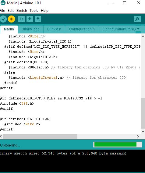

I've been attempting to upload the firmware a few times ... I get close ... but the Arduino seems to freeze before upload can complete ...
It stops at just before completion as shown below ...
This is for the "Full Aluminum Frame I3 Prusa Reprap 3D Printer"

Re: First Start Up Wiring Problems ??
It finally changed to 'Done Uploading' ... I thought for a moment I finally had it right ... BUT ...
A long list of 'timeout's down the page ... ending with 'timeout communicating with programmer' ... the ending with 'failed miserably to execute command 0x11' & 'failed to leave programming mode'
I've got a direct connection between the computer and printer ... with nothing else tied in ...
