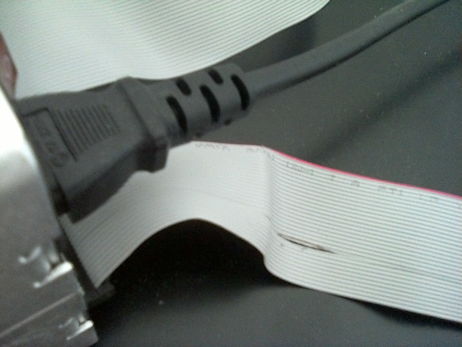

I have taken a picture of the ribbon cable if the location of the burned wire can give you an idea of where exactly the problem is
Kind regards
Peter
Re: Prusa i3 a pro. Ribbon cable melting
Wow,It looks serious actually.I suggest you to buy a new one to replace it.

Another picture that is a little better
