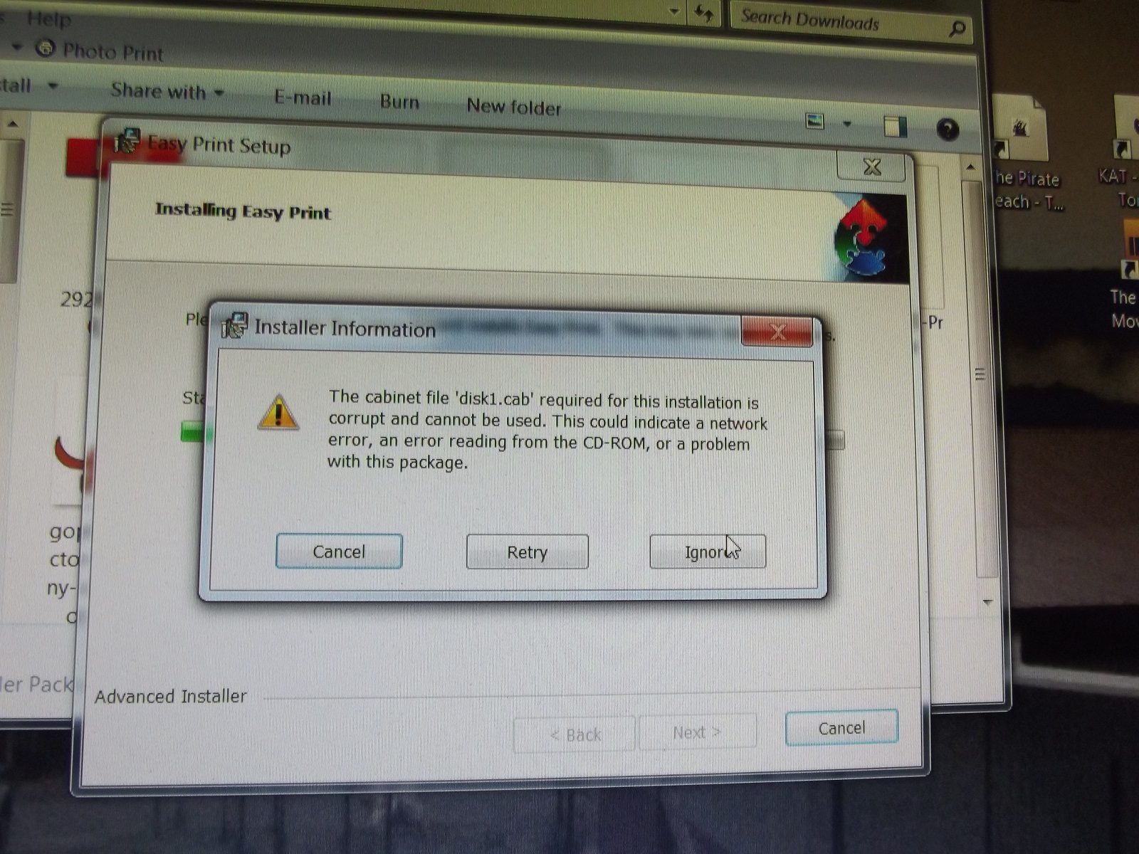

Ok here is the problem . I have downloaded the Easyprint program but when I try to install it I get a message that says a "Cabinet file" is corrupted and will not install.
Re: Reloading Firware
Could you post some pictures about it?
It seems the software is broken.Try to redownload it in this link:http://www.geeetech.com/specialpage/software/.
