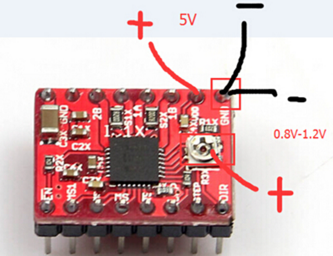

Maybe you can add some Lubricating oil to the Y-axis to make it move smoothly.If the motors do not have enough power to move the related axis,you can increase the voltage between VDD and GND on the driver board of GT2560,just like the pictures showing.

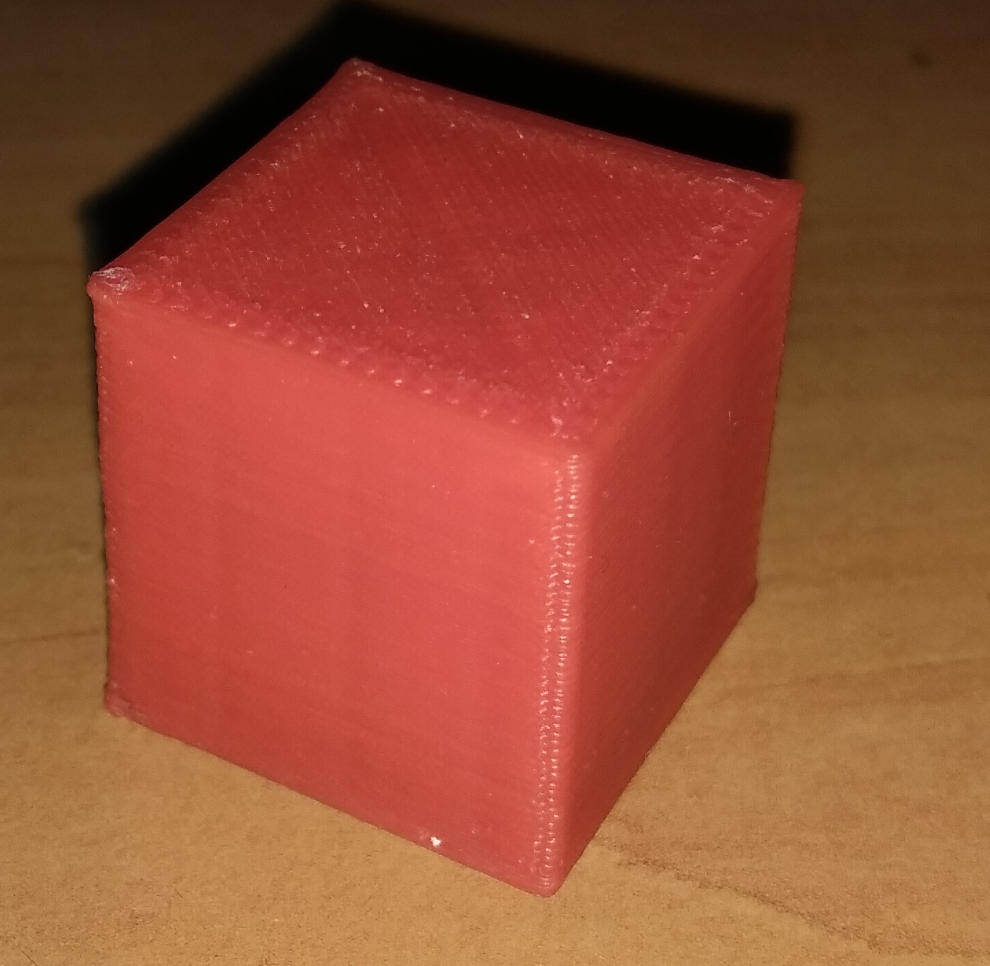

i was printing like this before the printer get sick. 0.1mm

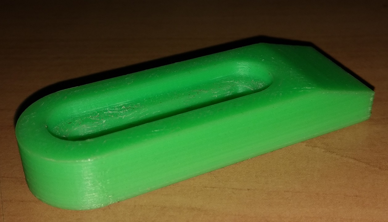

then i print a calibration cube 0.2mm

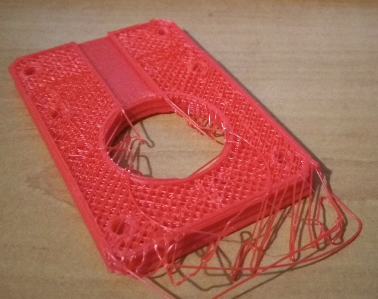

and then everything is going to hell xD, in some point the y axis was not be able to move and printed this

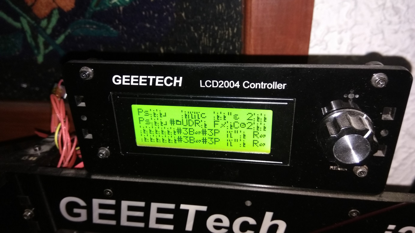

and the lcd D:!!
Re: Problem with geeetech prusa i3 pro c
As to LCD issue,you can click the Reset button under the knob.If it still the same,It should be the firmware issue.
At first,go to LCD menu and click:Control>Restore Failsafe.
If it still the same,just re-upload the latest firmware.I suggest you to upgrade the firmware with EasyPrint 3D.

Hi, Have you tried adjusting the drive board voltage?
