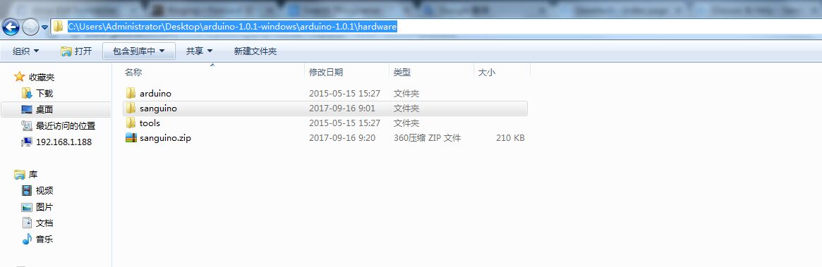

I just bought the Geeetech 3D Printer Aluminum I3. Everything is built up and mechanical is everthing fine. But I try to get access to the firmware, because I have to change some values because of wrong direction of the axis. But I have no stable access to my firmware, that means I cannot upoload the firmware to the board.
I think the problem is my driver. When I run Arduino 1.0.1 I have no possibility to choose the Sanguinololu as Board. I have communication with 3D printer with the repetier host software.
Have you got any suggestion, why I cannot choose the Sanguinololu as Board in the Arduiono Software? My PC runs with windows 10

You need the sanguinologu folder I attached and put them into the hardware folder. Then restart the IDE and select the right board.
viewtopic.php?f=20&t=16433
You can refer to this post.viewtopic.php?f=20&t=16433
- sanguinologu.jpg (43.03 KiB) Viewed 18584 times
