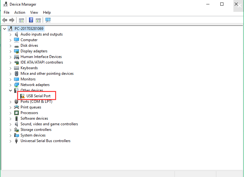

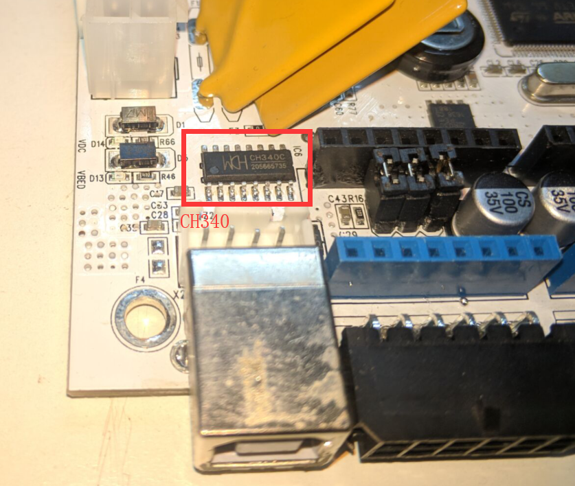

When you connect your printer to your computer, and your computer can not detect the printer like the picture shows, you need to install the driver for it.

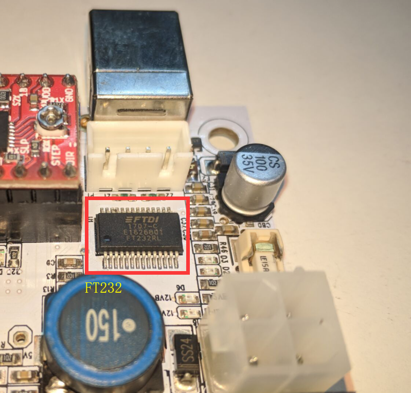

The first thing you need to do is check your USB communication chip, there are two type: FT232 and CH340. you can check the chip near the USB port. Usually, FT232 is a square, and CH340 is a rectangle
CH340 FT232 Drivers

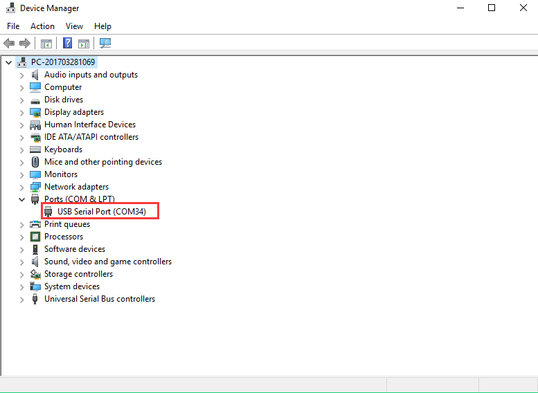

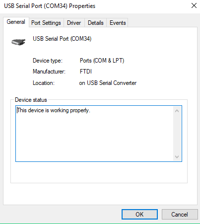

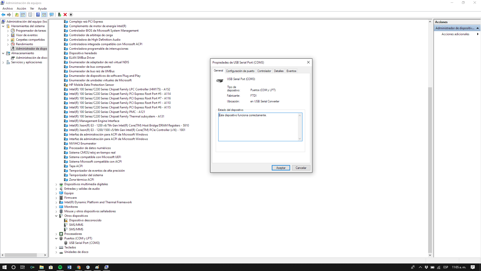

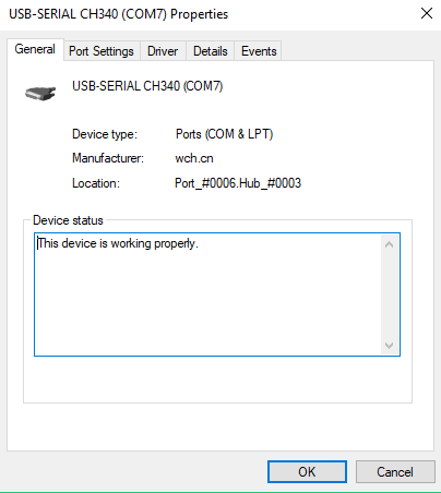

If the drivers install correctly, you will find these on the device manager:
For FT232 --------------------------------------------------------------------------------------------------
For CH340
CH340 FT232 Drivers
For CH340

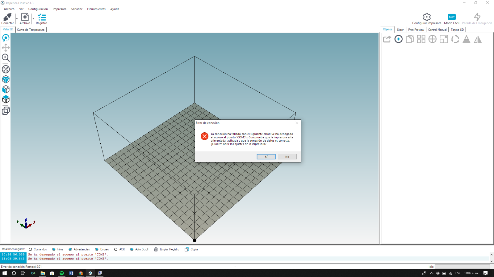

when i click connect on Easy Print the message i get is Access to Com port 3 denied, I have tried all the links on Geeetech none opened for me to install driver.
Re: USB driver for your printer
Hi.
This problem is due to your operating system.
Try to work with administrator privileges.

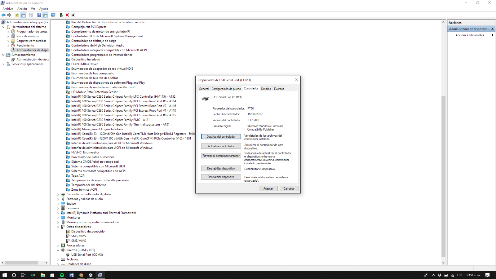

Hi, I've tried to install my 3D printer I already install the controller and the bus serial is fine.But the problem of "Access to COM Port 3 persists. I hope someone could help me with this.
