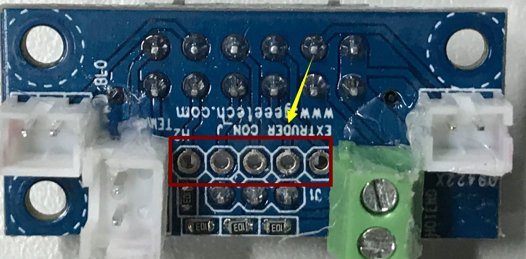

For users who wants your A30 work with 3dtouch/Bltouch:
First, you need to check if the "Extruder extension board" is standard.
You need to weld these 5 pins.

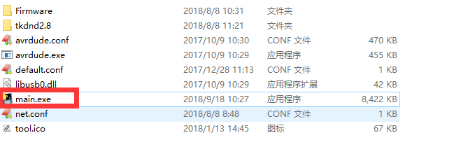

How to upload the firmware?(E180/D200/A30)
1, Download newest firmware tool from:
https://github.com/Geeetech3D/Smartto-Tool
2, Read the "README.md" file carefully and follow the instruction to upload firmware.
Update 2018.09.20:
We release a new firmware tool:
applications->
smartto_upgrador_1_2_forWin.zip
smartto_upgrador_1_2_forMac.app
PS: Please choose the mode "upgrade it from local"

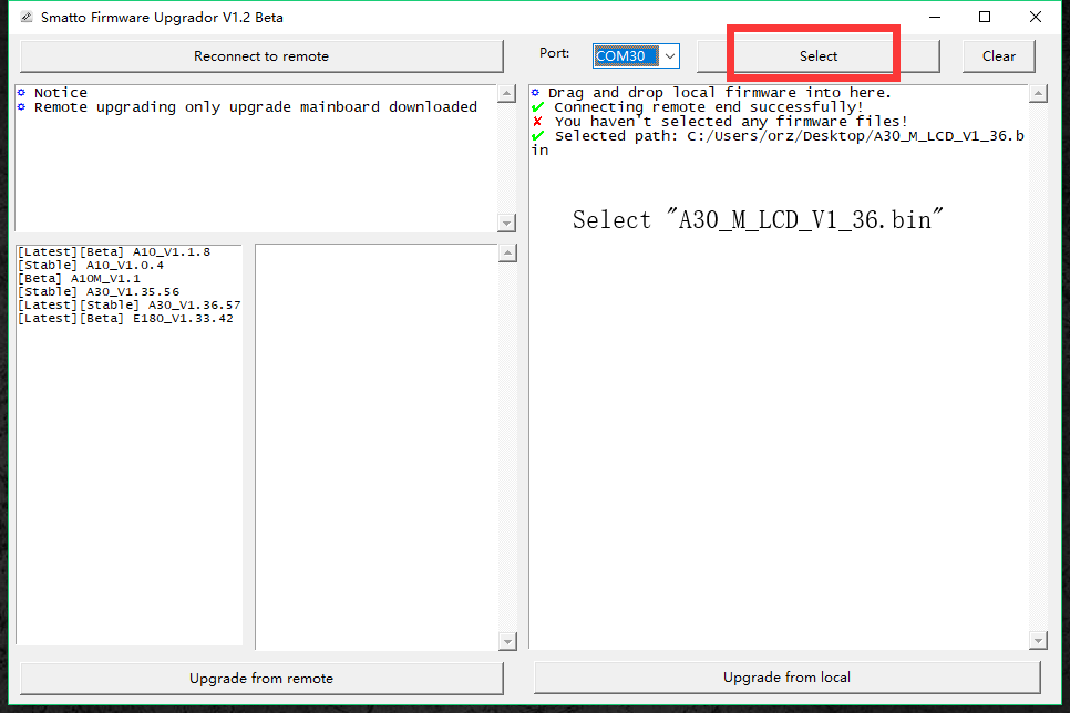

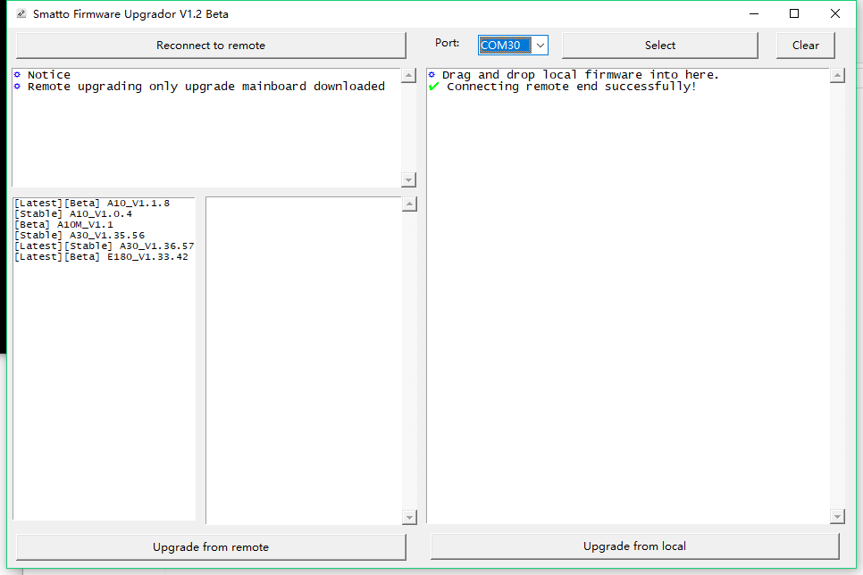

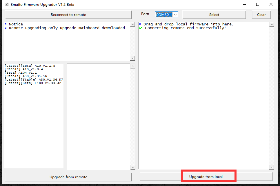

1.Open the Smartto firmware upgrade toolkit 2.Choose the correct USB port and select the LCD firmware 3.Select the LCD firmware for A30 4.Upgrade from local 5.Restart the printer

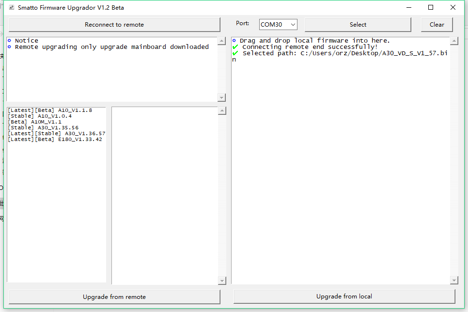

6.Select the mainboard firmware for A30 then click upgrade from local
