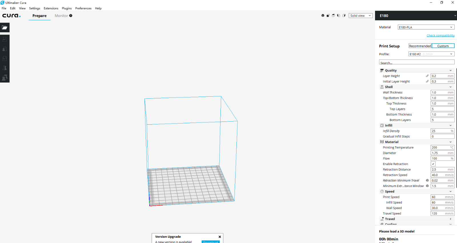

Today I want to share one of my own Cura profile for E180
1.Print area setting

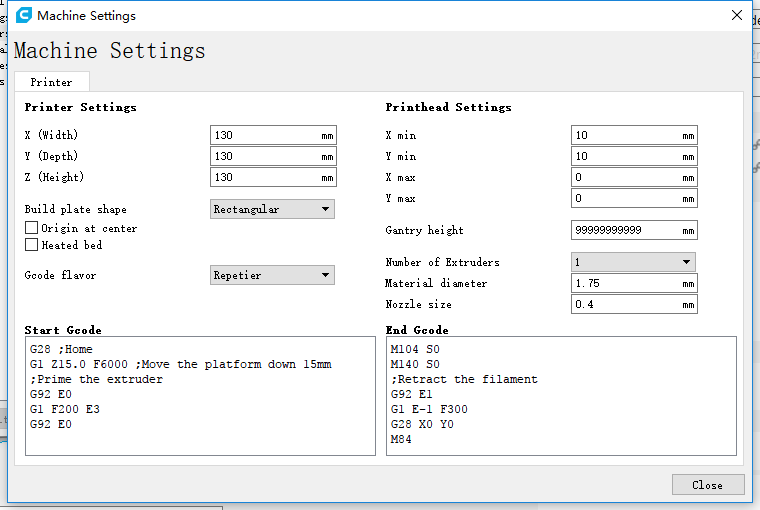

2.More details

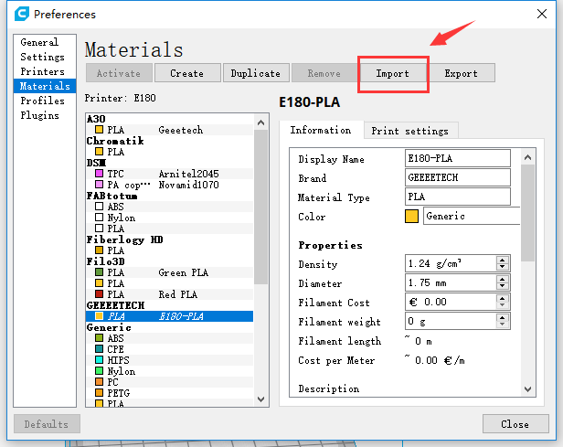

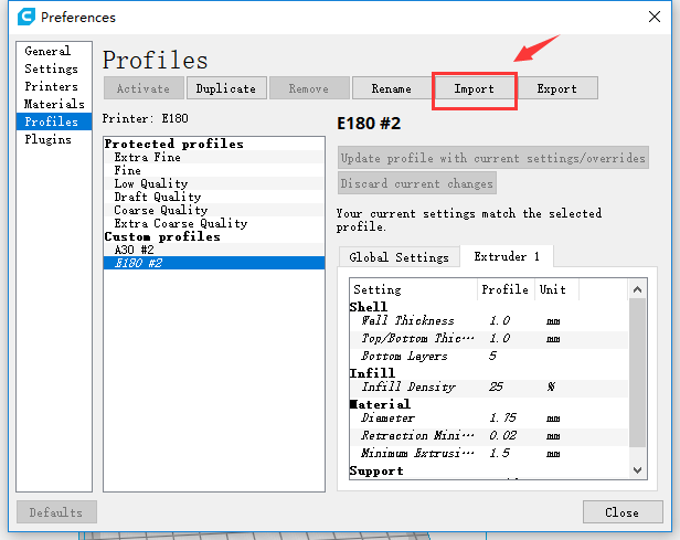

3.Download it and then import it
