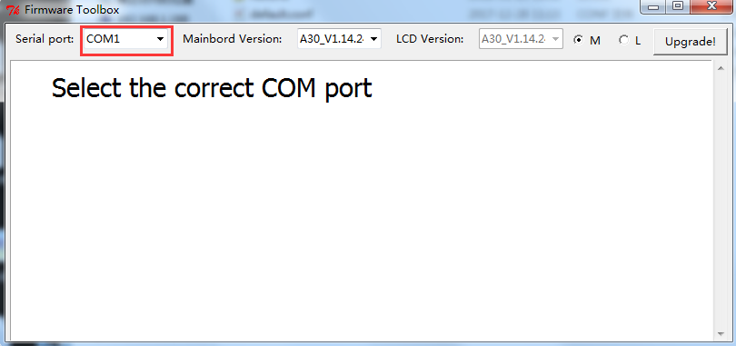

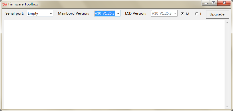

If the Z axis endstop of your A30 is on the bottom , you can install this firmware.
Connect your printer to your computer with USB cable, then choose the right COM port.
choose the right version, then click "upgrade"
