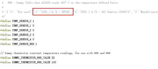

"100k thermistor - best choice for EPCOS 100k (4.7k pullup)"

Thank you, Gingko, for your reply.
So I understand that in both places there is mounted a glass thermistor NTC 100kΩ.

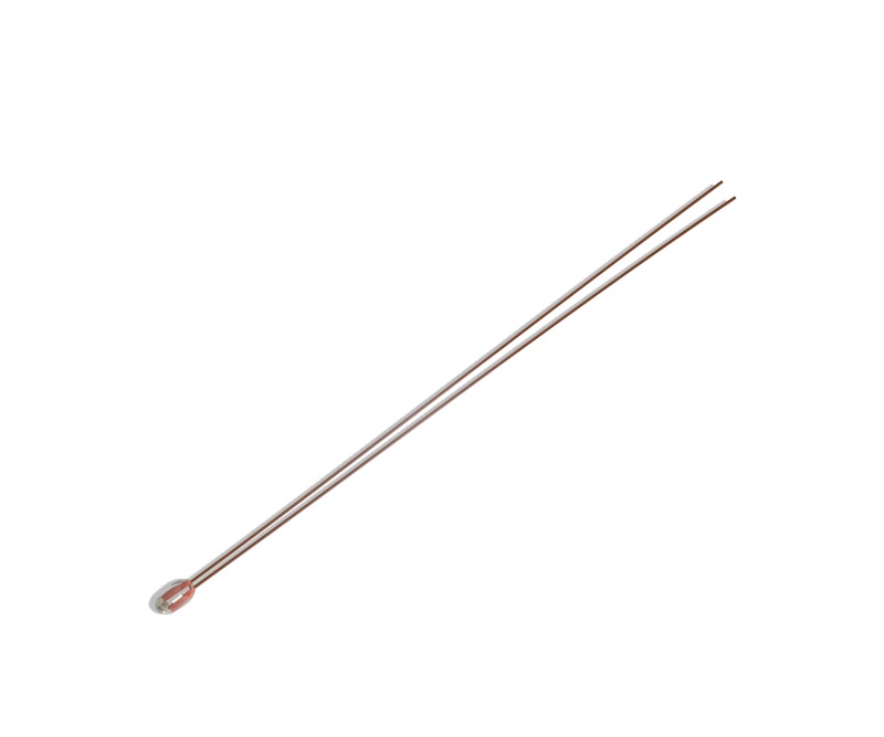

The element with axial arrangement of leads is most probably the MF58 series.
http://en.ampron.com/prod_view.aspx
seria MF58
seria MF58

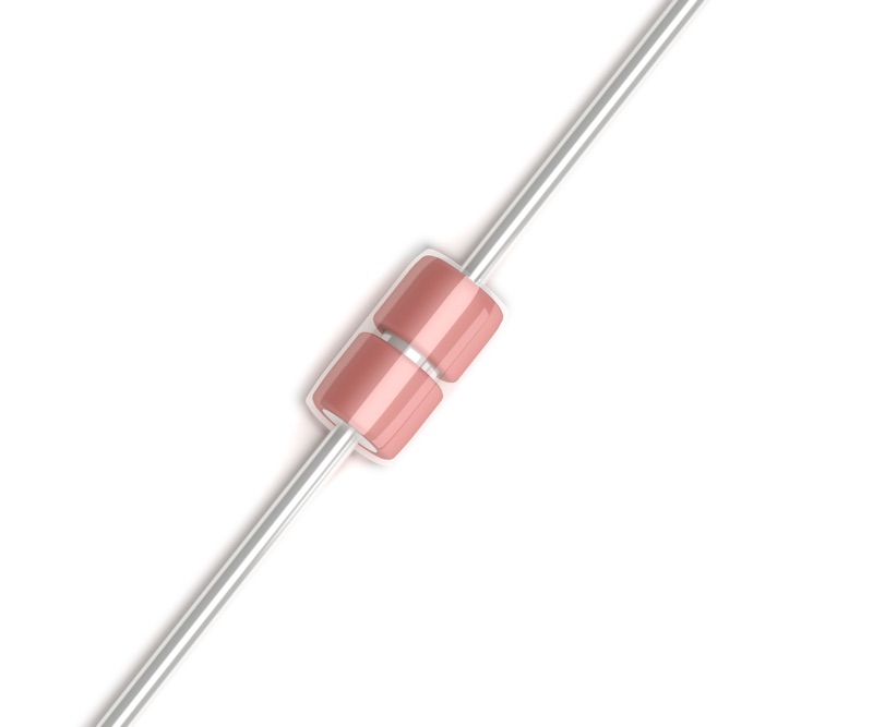

The second type of thermistor can be the MF58D series.
seria MF58D
seria MF58D
