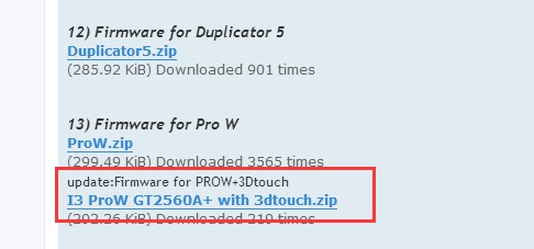

I use this firmware

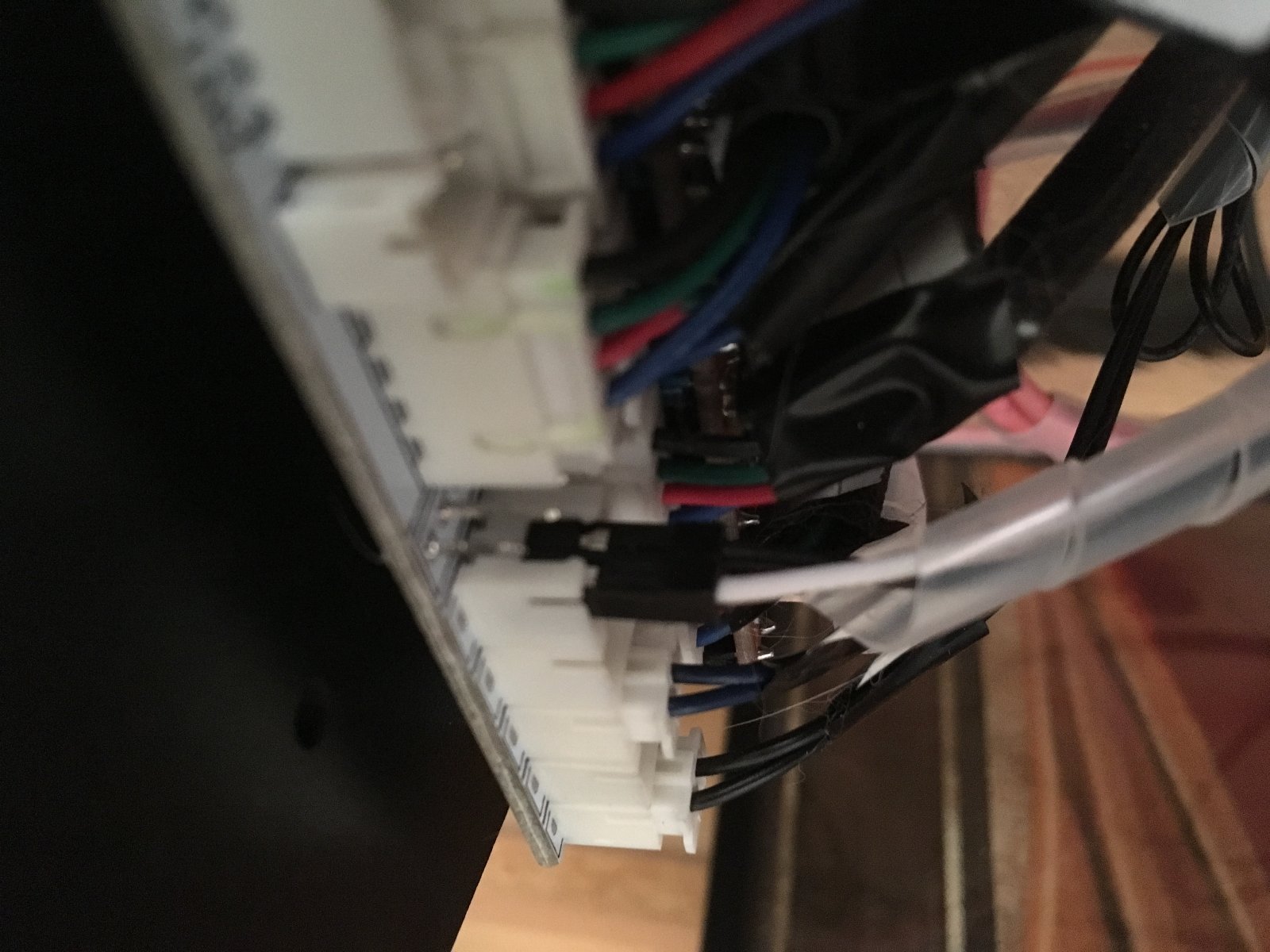

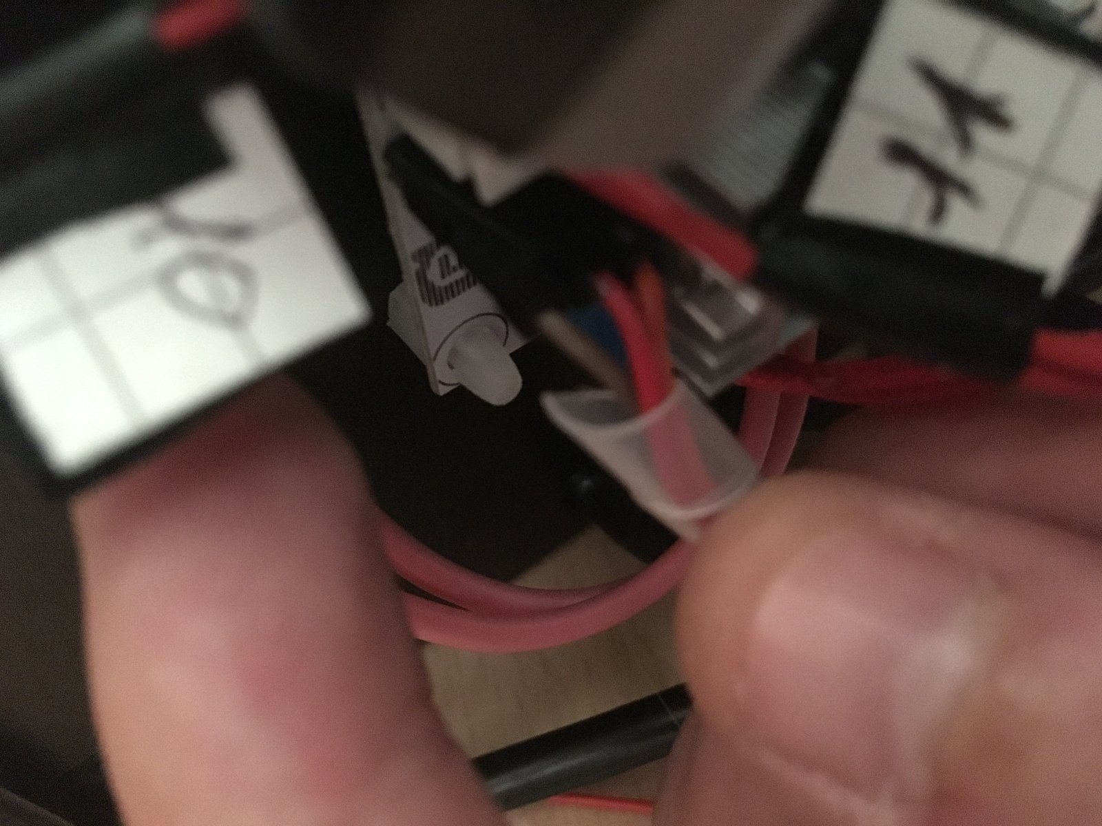

Also here my wiring
cable bn.JPG (255.55 KiB) Viewed 18337 times
cable rom.JPG (266.09 KiB) Viewed 18337 times
So, all is good with the selftest but, when I try to Home, the pin goes up and never do it's job.. :cry:
