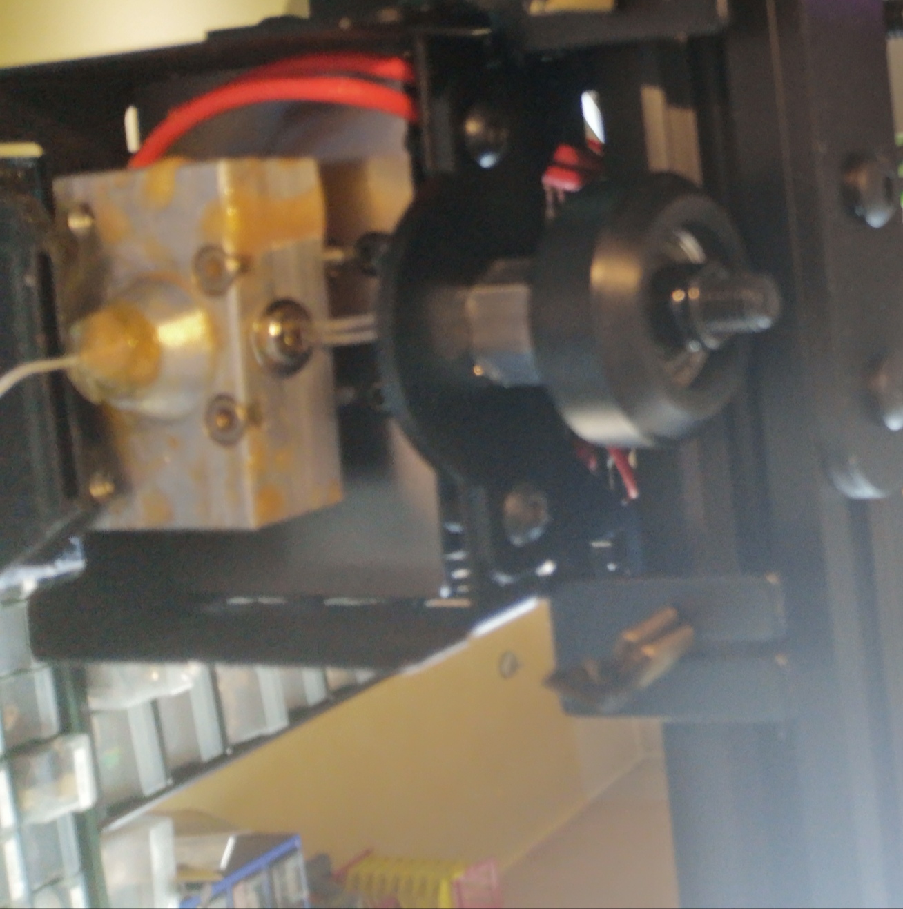

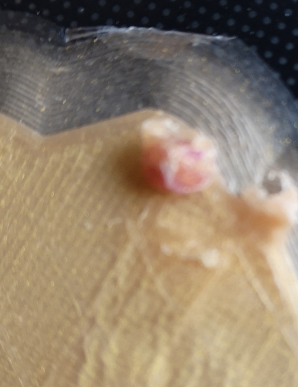

I had a lot of issue before being able to make stick my print....
Investigating further, I discovered that the print didn't stay flat but had some "large drop" randomly
On the basis of the joined pictures, I have the feeling that the main reason is a PLA leakage.
I'm not really enthusiast to try to fix by myself, the printer being brand new (just unpacked yesterday) and the assembly of the head looking complex
Is this a common issue ?
Do you already encountered this (maybe defective series) ?
I guess that contacting the seller is the best thing to do.
Thanks

Did you heat it up after assembly and then perform the final tightening of hotend components while it's hot? If not, give it a try.

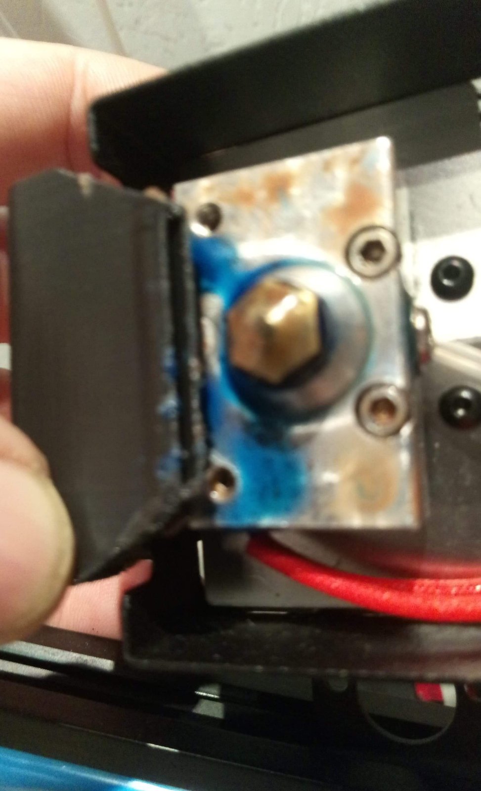

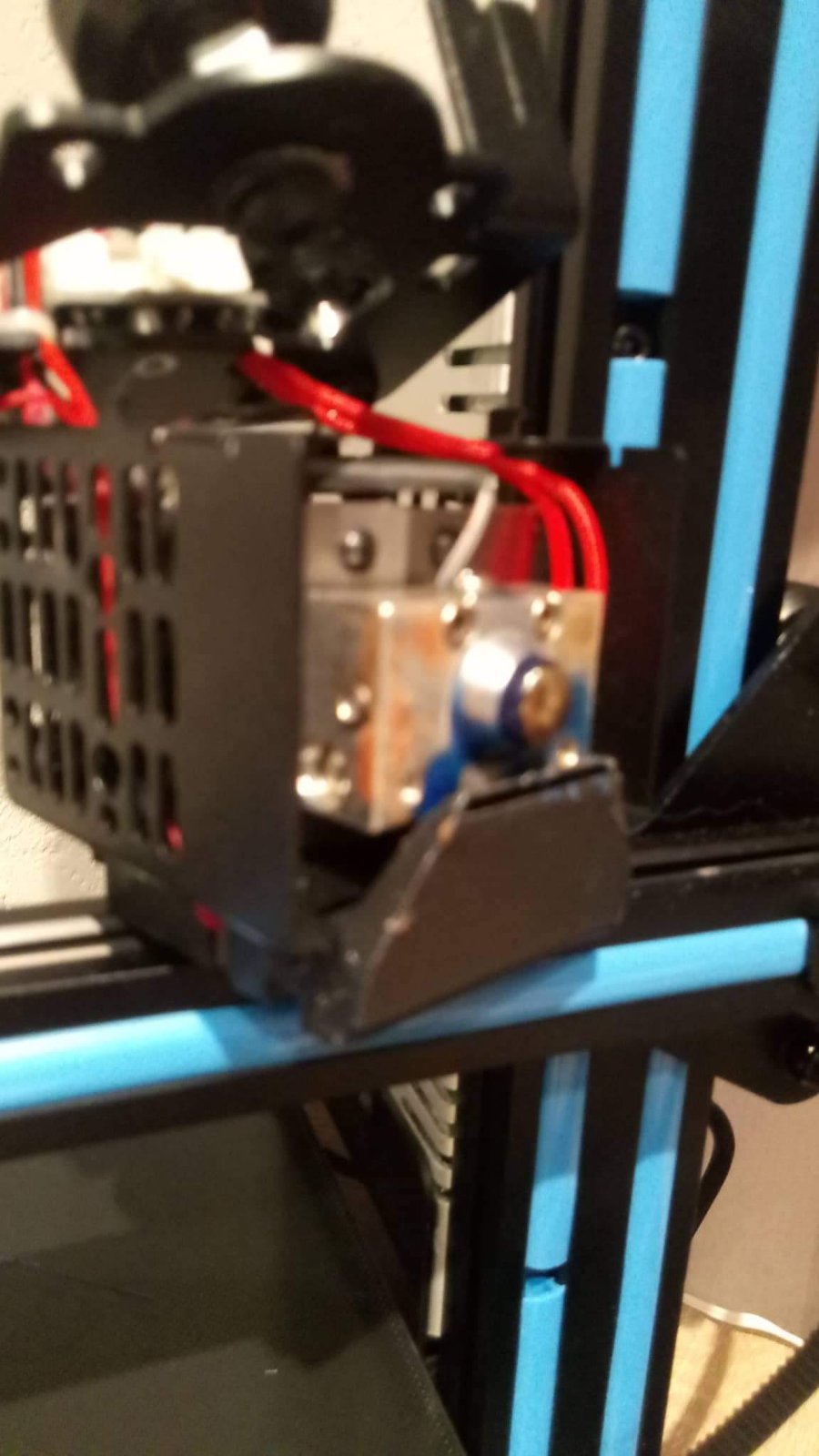

Hello,
I have the same problem, and I have read it often.
Also in the reviews on Amazon.
Geeetech, what are you going to do about it?
Are we getting a new improved Hotend sent?
I have already written to Arron, and wait for an answer.
For me this is a guarantee case and I firmly believe that Geeetech will find a solution.
Until now, I have always been helped very well.
Greetings Norbert

Hello,
I purchased a new "head" on geeetech spare part site and it solved the issue.

You can ask the sales to send you the new version hotend.jupesch wrote: Sat Nov 17, 2018 5:42 am Hello,
I have the same problem, and I have read it often.![]()
Geeetech, what are you going to do about it?![]()
Are we getting a new improved Hotend sent?![]()
Until now, I have always been helped very well.![]()
Greetings Norbert
The old vesion hotend exist this issue,we improved it.

Hi William,
THX, the new one is arrived and works great.

I have the same issue, but not so much as yours. I have this one: SKU:700-001-1121 <-- is this the old one?
