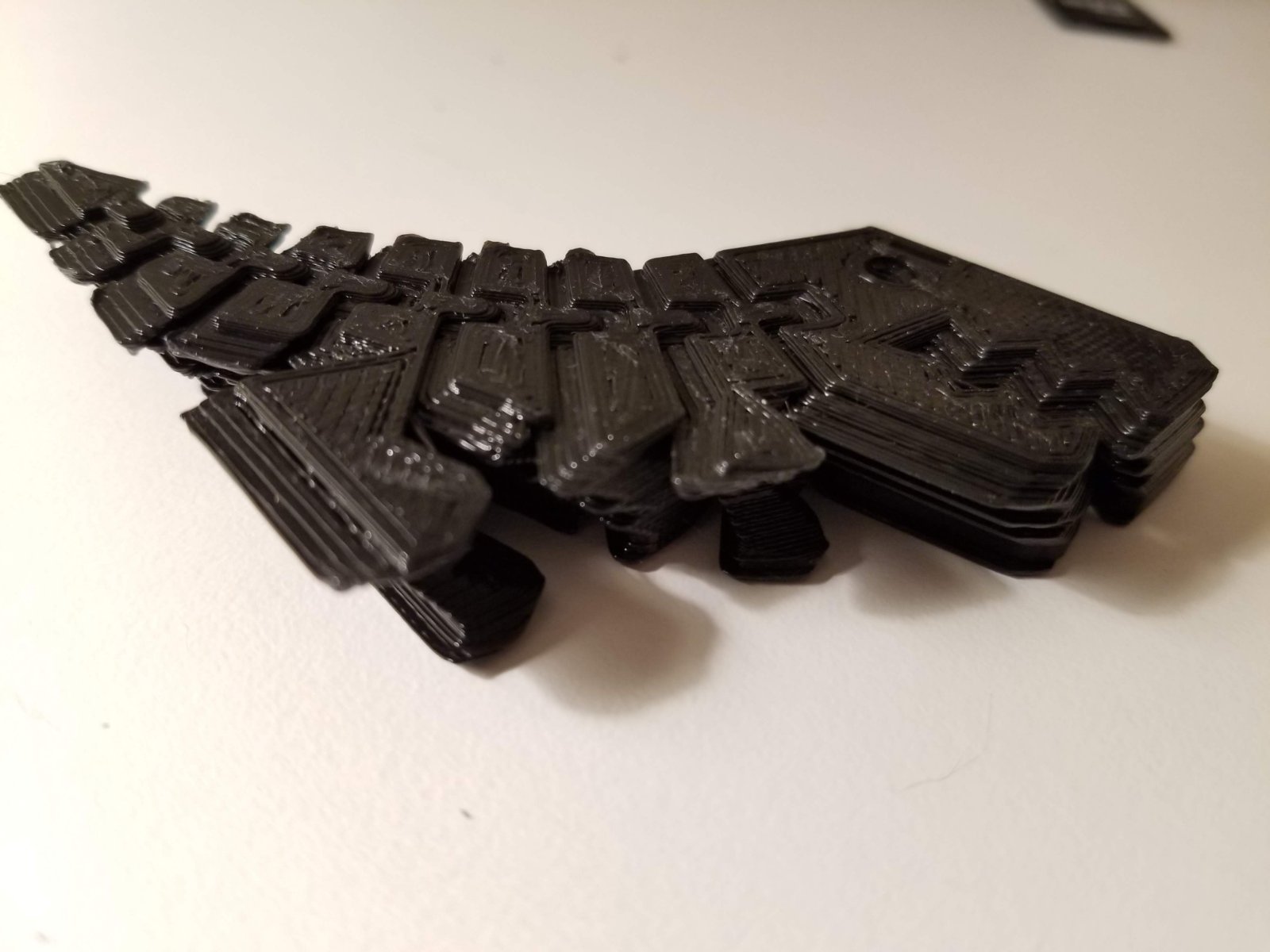

So.... I'm getting some pretty bad layer shifts.. I checked the obvious. The bed moves freely and doesn't catch. The belt doesn't seem too tight to me.
I've been having a really hard time printing anything on this printer. I've tried Cura with the profile that's on forum. I couldn't get anything to stick to the bed. So I tried out Slic3r.
First layer went down pretty smoothly.
My travel speed was 120 mm/s ; That was probably a bit high. I'll lower that for sure.
Print speed was 60 mm/s
So after printing like this for 2 hrs, is the stepper motor toast?

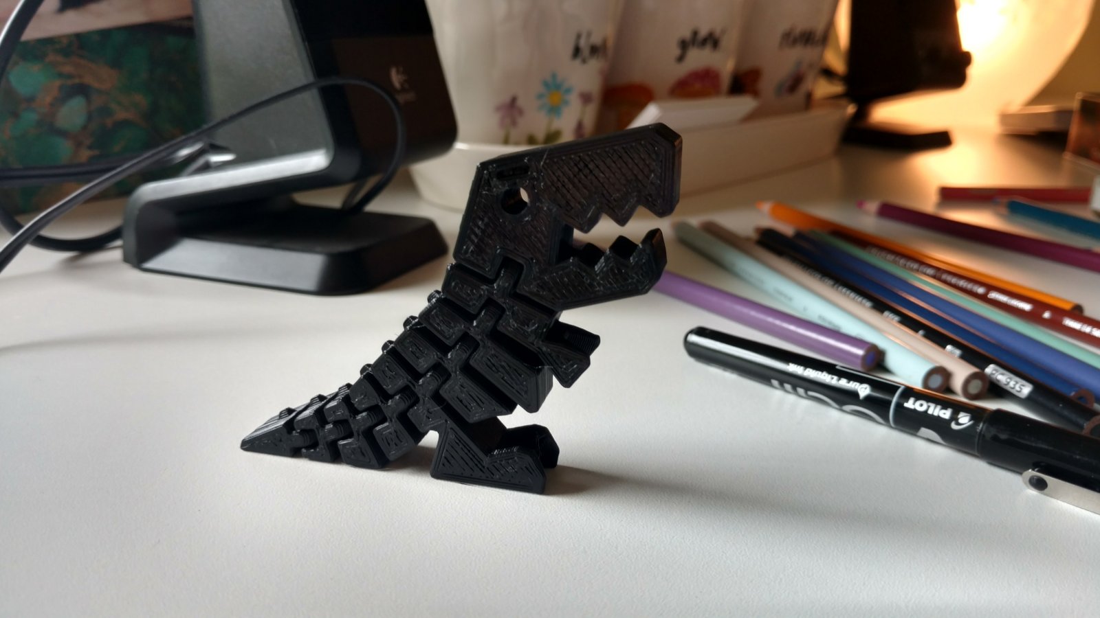

So I slowed down the travel and print speed and tried again. The second guy came out pretty good.
I'm working with Slic3r 1.29.

I did tighten up all my belts and Y carriage. But it turns out I had them too tight. Also, I had the A10 printing the infill at 80mm/s. So that's why I had the crazy layer shifting.
