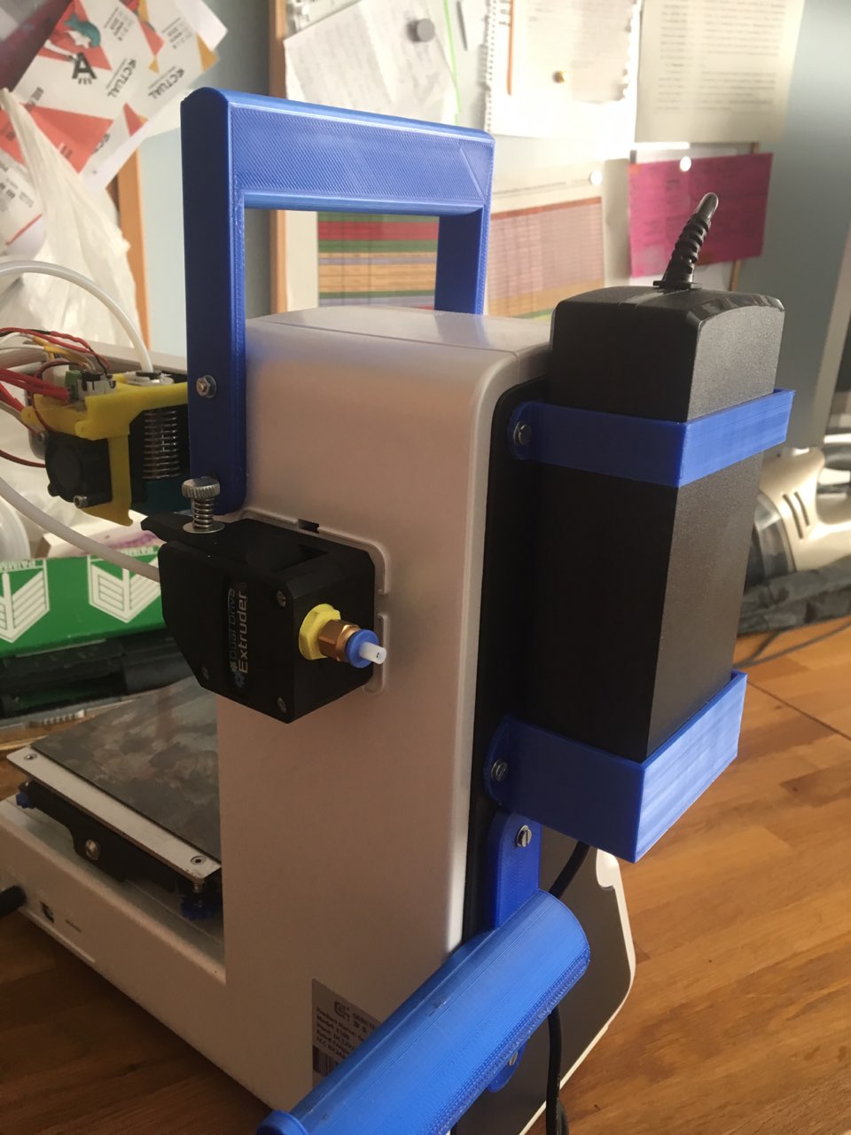

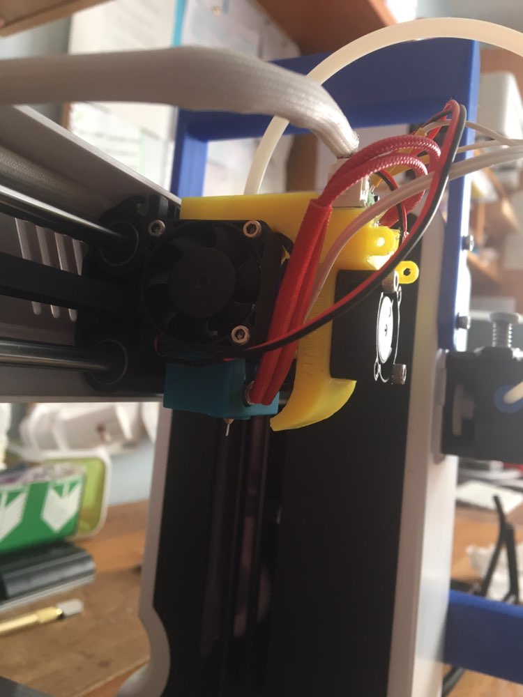

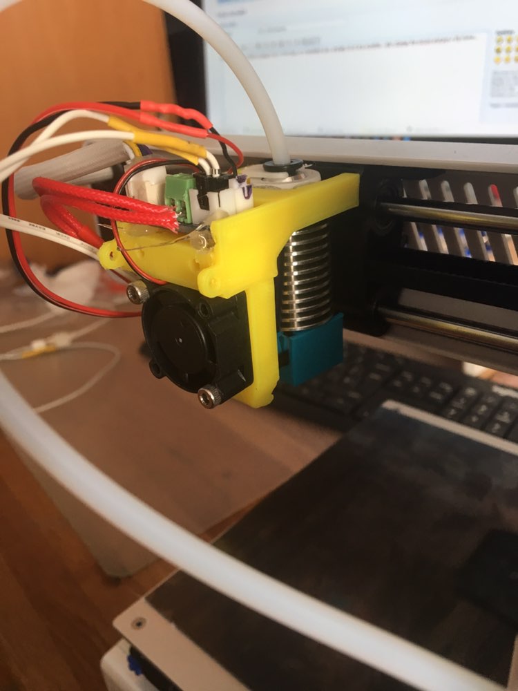

stock extruder is rubbish, change it for a titan clon, or a bondtech clon, and get rid of any troubles...also change the nozzle and put a V6 clone...
- photo5823591030920949466.jpg (133.44 KiB) Viewed 51814 times
- photo5823591030920949464.jpg (75.09 KiB) Viewed 51814 times
- photo5823591030920949465.jpg (75.02 KiB) Viewed 51814 times

Currently I am very unhappy with the printer's E180 nozzles (horrible).apak wrote: Wed Dec 19, 2018 5:33 pm stock extruder is rubbish, change it for a titan clon, or a bondtech clon, and get rid of any troubles...also change the nozzle and put a V6 clone...
I have 3 obstructed and it is impossible to use them (unusable). The nozzles are poorly manufactured and sooner or later the extruder be blocked ...
@apak Could you share the .STL to change all complete nozzle/extruder and place a titanium clone or similar like yours? Thanks friend.
Re: E180 extruder
No can do!!! It´s not mine to release, I am helping the developer (Carlos Arruti) but he´s got very busy and not much done for months...still need to improve cooling, but I am pretty sure he will release it.Trademarkos wrote: Tue May 28, 2019 11:30 pmCurrently I am very unhappy with the printer's E180 nozzles (horrible).apak wrote: Wed Dec 19, 2018 5:33 pm stock extruder is rubbish, change it for a titan clon, or a bondtech clon, and get rid of any troubles...also change the nozzle and put a V6 clone...

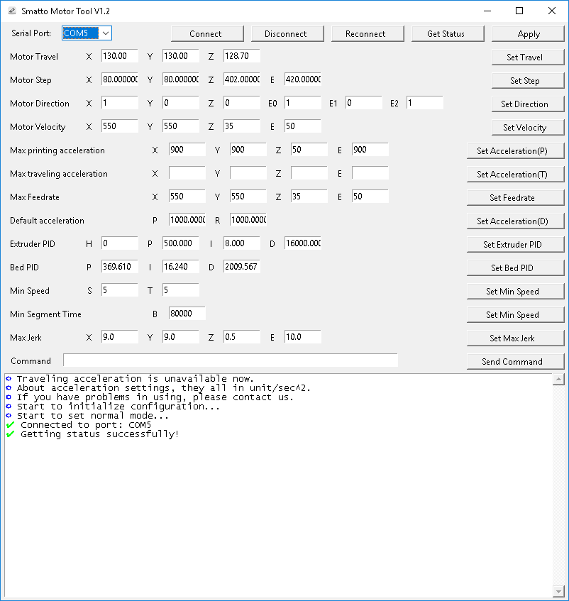

Hey apak, I have been struggling to find some help on this, I am looking to change the hotend on my e180 but I am having a nightmare with the pid setting. Could you help point me in the right direction on how to get that sorted
Re: E180 extruder
This are my V6 settings for PID, but I´ve already got rid of smartoo
That´s an easy mod, cheat, and with excelent prints after that.
https://www.thingiverse.com/thing:3680288
There you have details for changing the board, and the V6 X carriage mounts....by Carlos Arruti
- settings E180 V6 01-19.PNG (28.58 KiB) Viewed 49290 times
