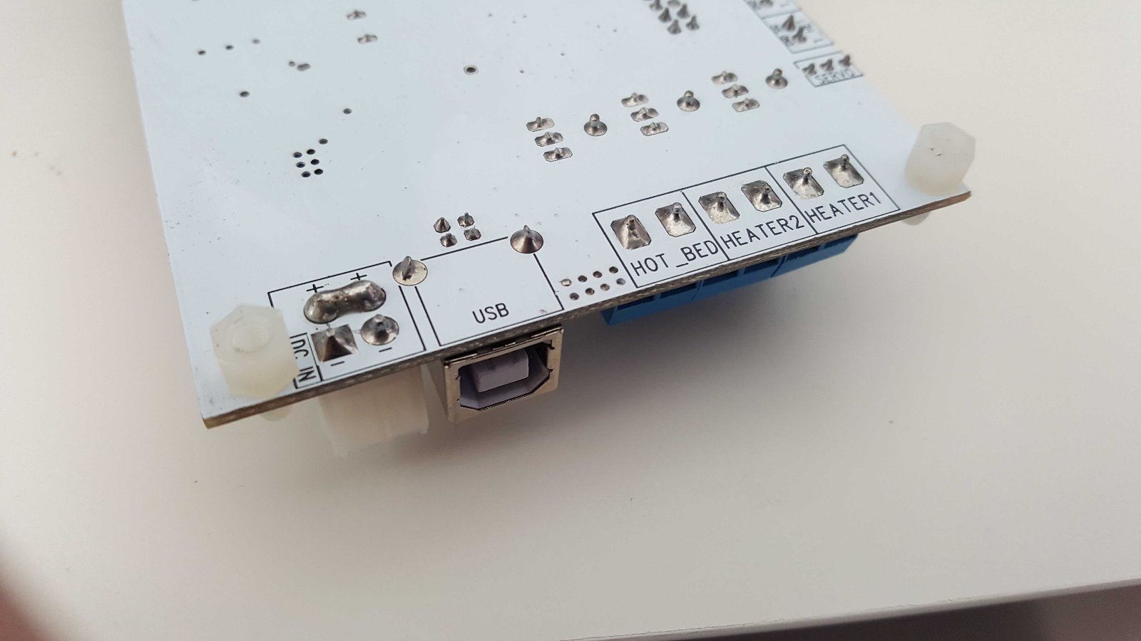

Specify the version of the controller board you have and place a photo on which it will show the area around the USB port of your controller board.

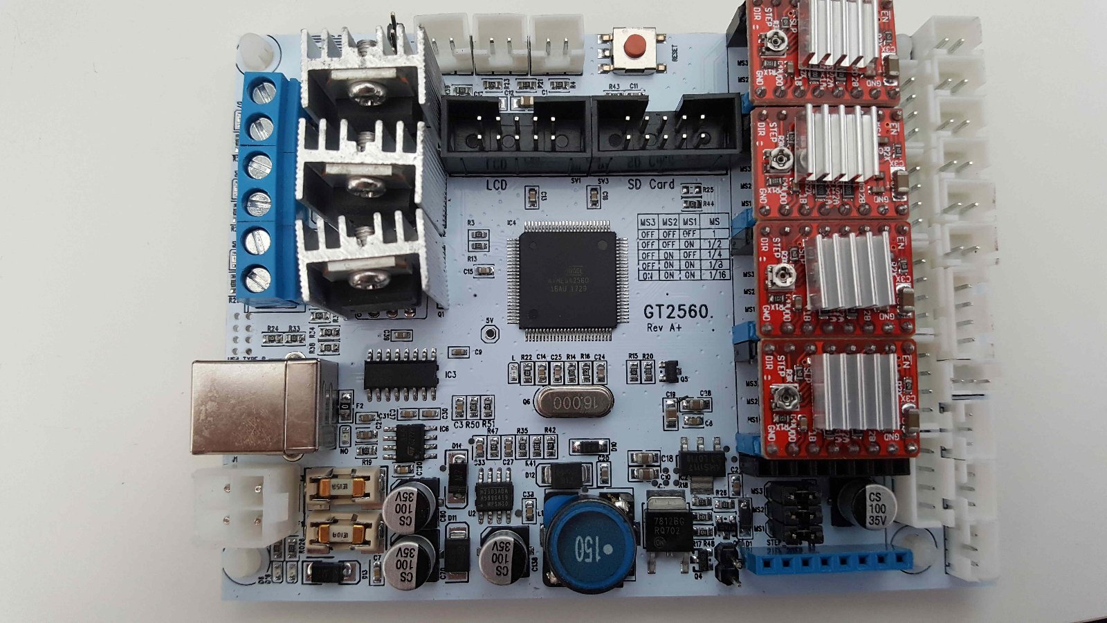

The board is a GT2560 REV A+
Pictures attached
Pictures attached

Picutres
- 20190203_1402222.jpg (118.68 KiB) Viewed 9444 times
- 20190203_1401332.jpg (285.64 KiB) Viewed 9444 times

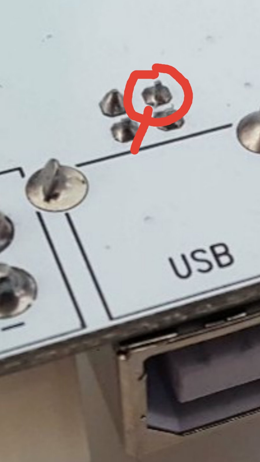

It looks like there is a short circuit from the upper right soldier point to the ground.
Do you have a soldering iron to fix it?

Hi.
The short circuit you noticed is awful. It contains data outputs D+ and D-.
This will disable communication to the printer but is not dangerous for electronics.
