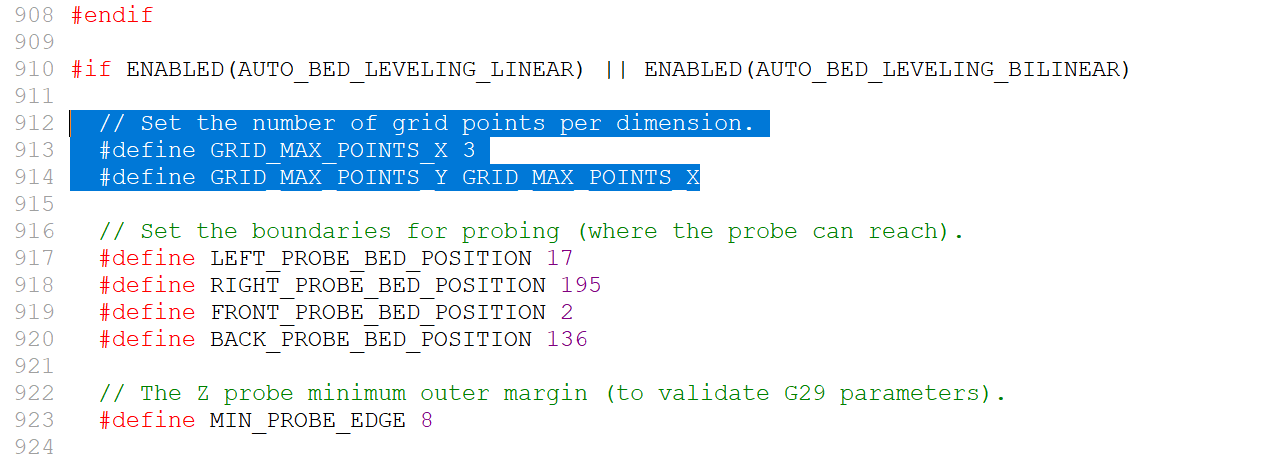

Re: Problem with Bed Leveling
Hi,you can refer to these line:

i need change 3 to 5... true?
