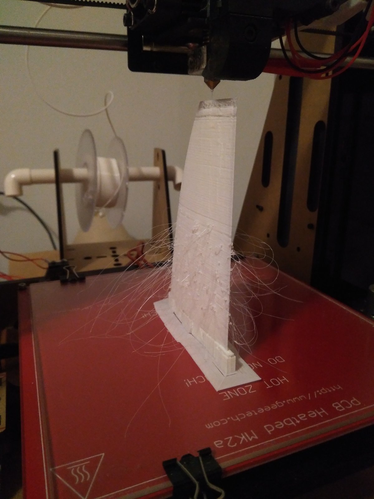

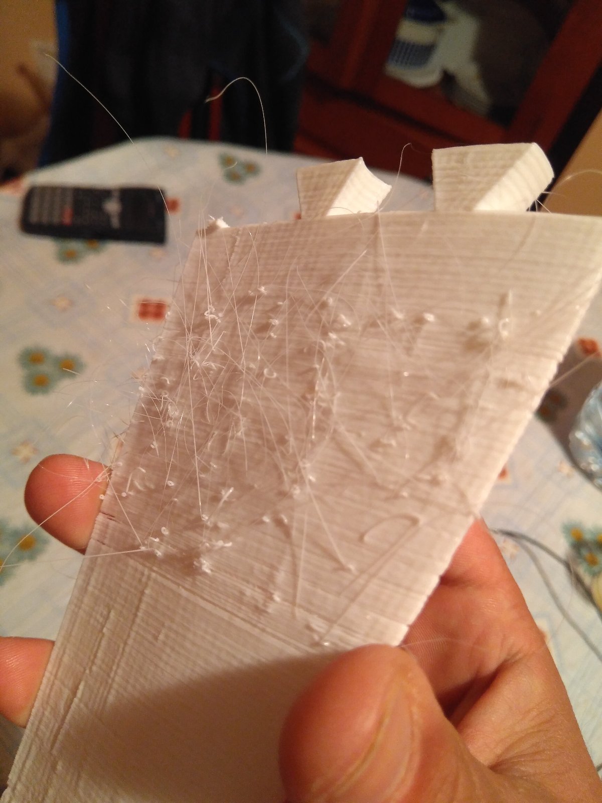

When printing, sometimes the extrusor suddenly leaves the piece pattern and travels in X or Y direcction until bed ends, come back and restart the print process. The result is a bad quality piece as the image.
Anybody experienced a similar problem? What could cause this behavior?

- IMG_20190310_001901_696.jpg (222.17 KiB) Viewed 6294 times
- IMG_20190310_001214_783.jpg (201.88 KiB) Viewed 6294 times

It seems your pirnter has a issue of retraction.
Try to check the gcode at first.Then check the temp of the nozzle.
For PLA:190~215c is ok.
Re: PLA threads on piece
Hello.
Some slicer programs have an option: cooling by retracting the head.
The effect may be similar.
I think it is not a retraction problem, the threads are created during the random travels the extrusor does until the end of the bed. I am not solved the issue yet . . . anybody have a similar problem?
