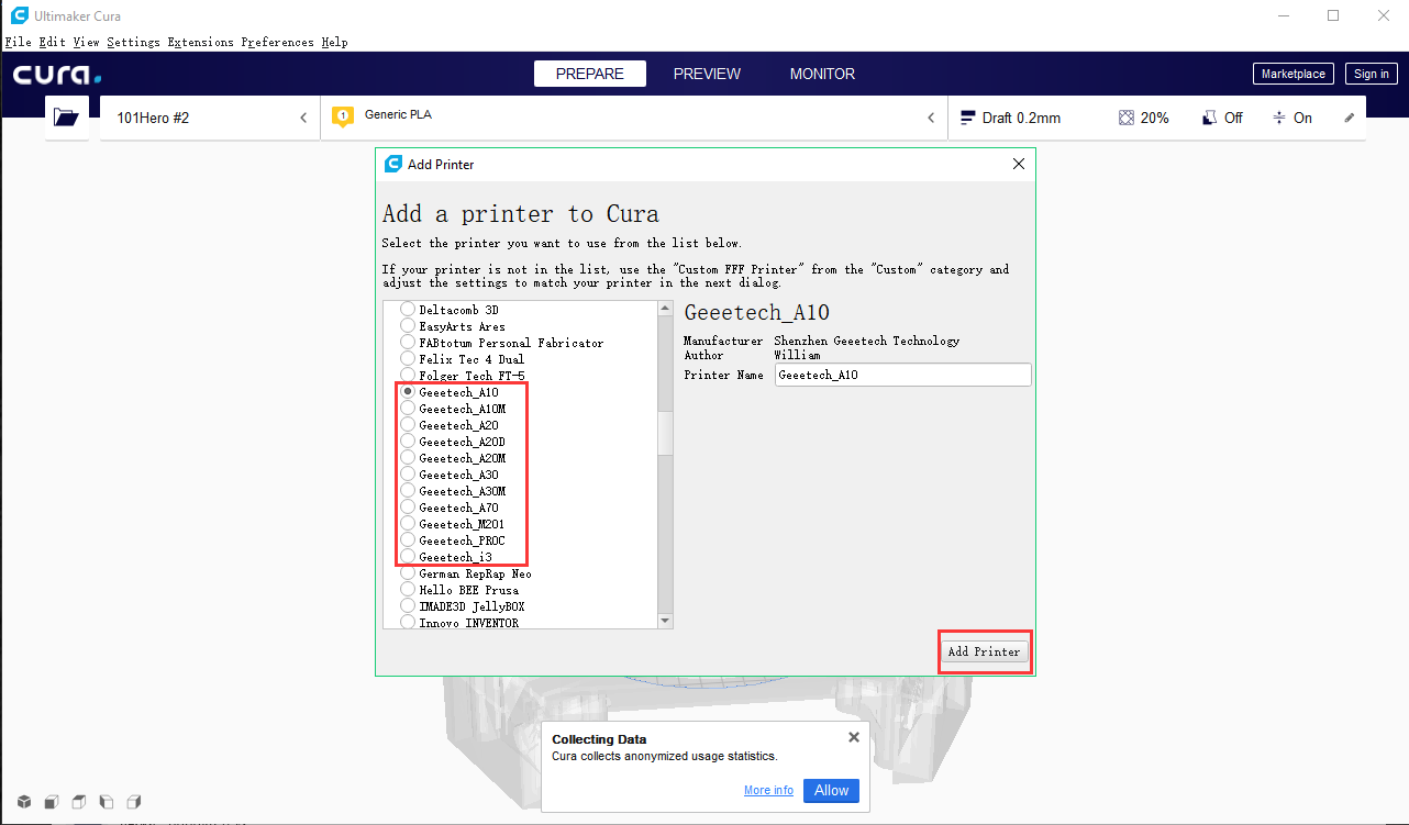

Are you can't find Geeetech A20 on Cura?
Don't worry
Refer to these:

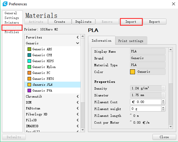

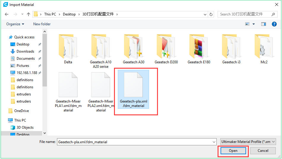

Download the PLA filament profile for A10M
Geeetech-pla.xml.zip
(932 Bytes) Downloaded 1840 times

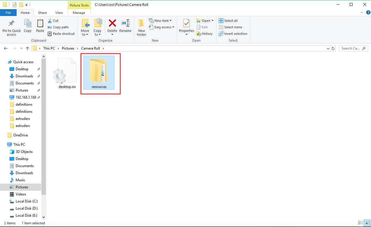

2. Unzip the zip file then you will get "resources"folder

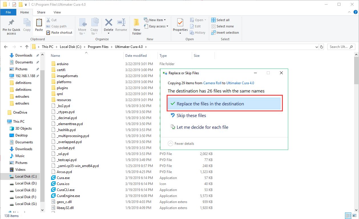

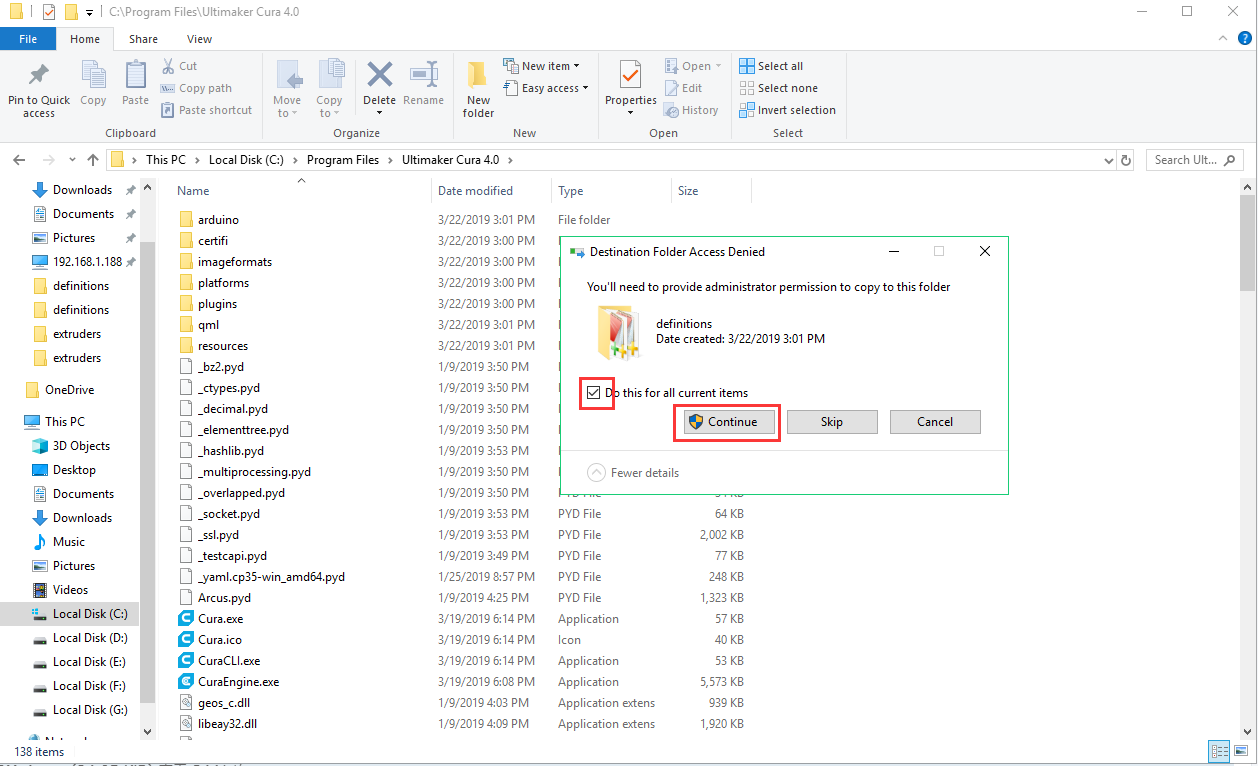

3.Copy "resources" to the
Cura installation directory
Default:
C:\Program Files\Ultimaker Cura 4.0
3.Import the PLA filament profile for Geeetech A10M
4.Done!Enjoy it!
