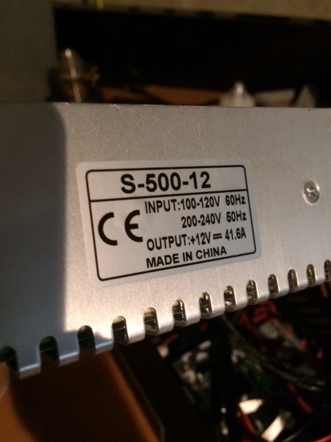

If you open the control box and drop out the power supply it will tell you if it is 12V or 24V.
I bought my A30 last year and requested the 24V system, but I received the 12V and after first couple prints the fuse on the back kept popping when the bed would heat up. So I opened it up and was not happy to see I received the 12V (S-500-12) when I requested the 24V. After a back and forth with Geeetech, they sent me everything for the 24V system to upgrade. I made sure to open the control box and check the power supply to see if it said 24V (S-500-24).
This is the 12V power supply. I am printing with the 24V now, so I cannot open and take picture.
12V power supply
12V power supply
