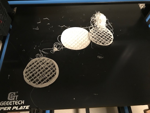

With help from the community, I was able to dial in the A30 heat bed. BUT... This is what happens during the print. Any suggestions?
Printer issue on the A30
Re: A30 Bed leveling
Hi, You may need to do the following
1. Leveling the hot bed;
2. Check the tightness of the belt;
3. Appropriately reduce the printing speed, the recommended range is 30-60mm / s.\
I hope this can help you.

Are you trying to print the A30 example file?
Is the print loosening from the plate and / or sticks to the nozzle?

Yes, I was trying to print the Monk that came on the micro SD card. It printed fine on my CR-3 Pro, but not on the A30.
I finally got time to work on the A30, I have created a g-code for a hand and it seems to be printing fine at the MOMENT.. But we will see if it completes
well.
