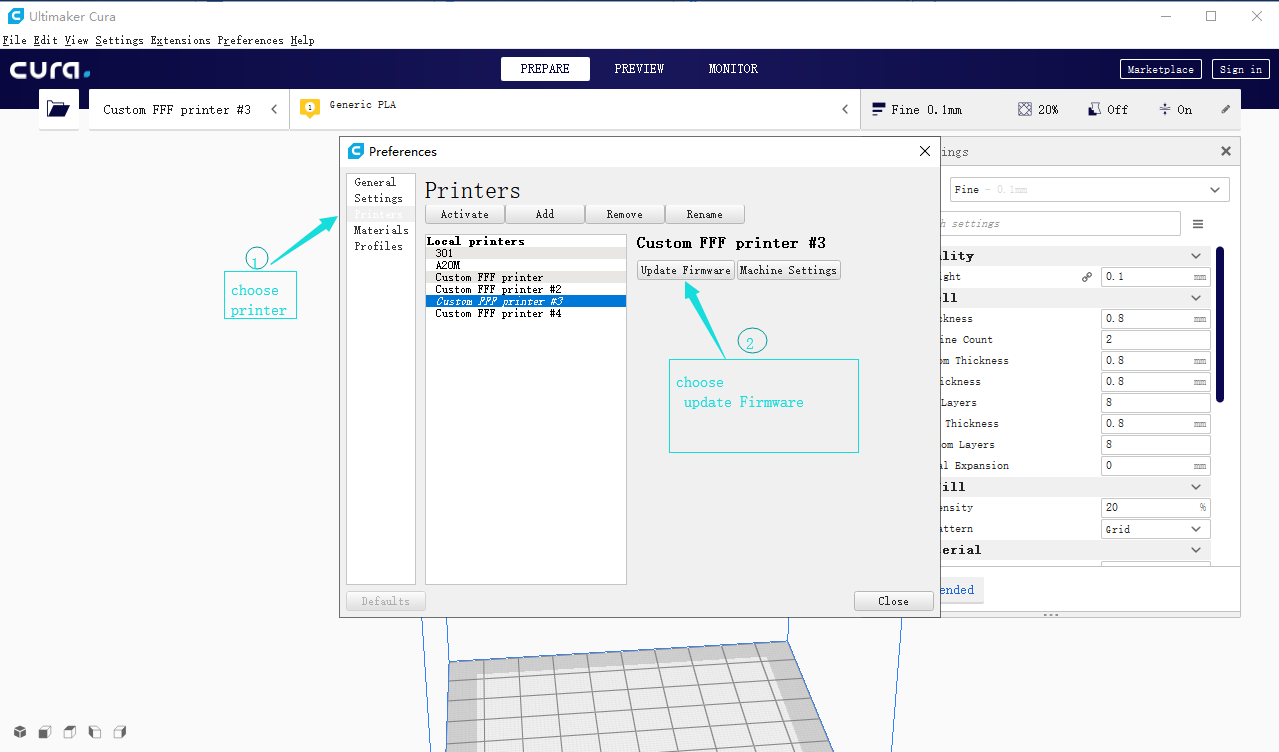

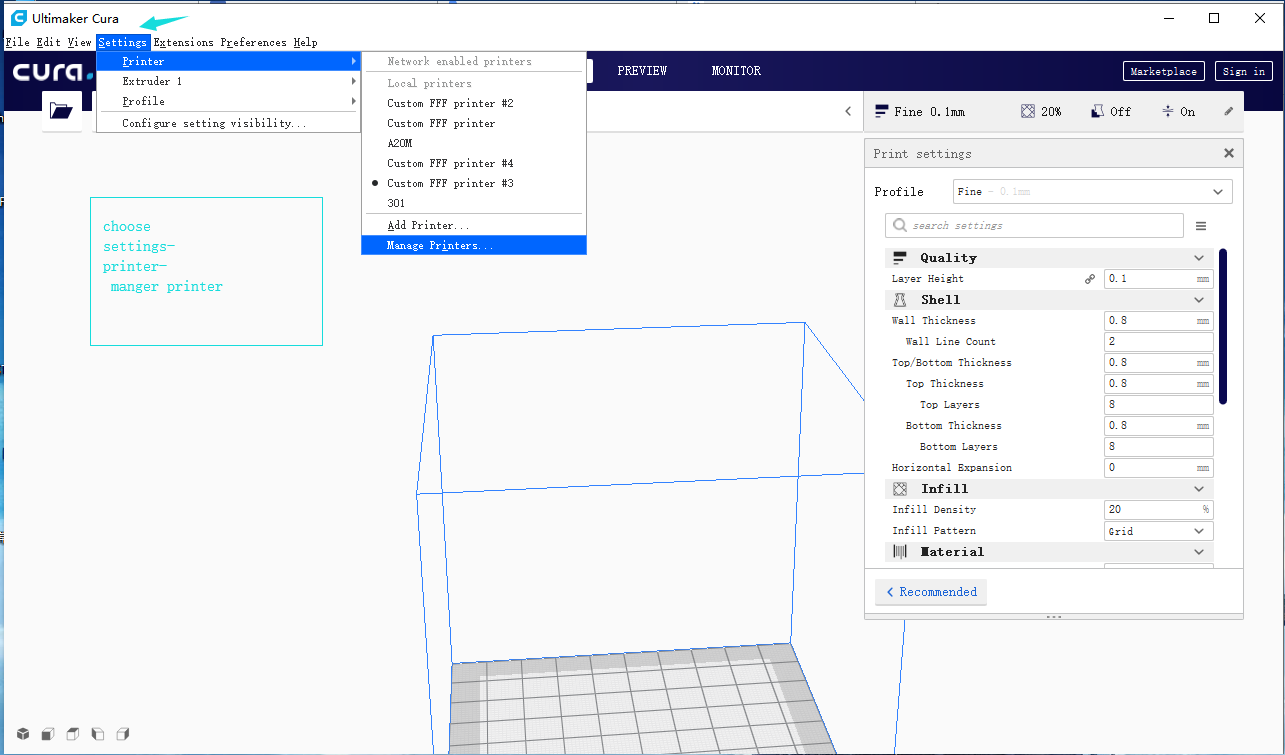

Hi, If you can't use marlin firmware,
You can try to download the still compiled HEX format firmware on the official website.
you can refer to this;https://www.geeetech.com/download.html?download_id=34
Connect the printer to the firmware update via CURA slicing software.
You can use the settings-printer-manger printer
To update the firmware.
I hope this can help you.

ok so after a new graphics card software and a lot of swearing I now have cura running, however when I got to update firmware it only gives me the option of using custom firmware which I do not know how to do on this program
any advice?
many thanks
Re: Reflashing firmware
Hi, If you can't use cura,
The version using Arduino should be version 1.0.1,
According to your own motherboard type
Download the appropriate firmware: http://www.geeetech.com/forum/viewtopic ... 20&t=17046
