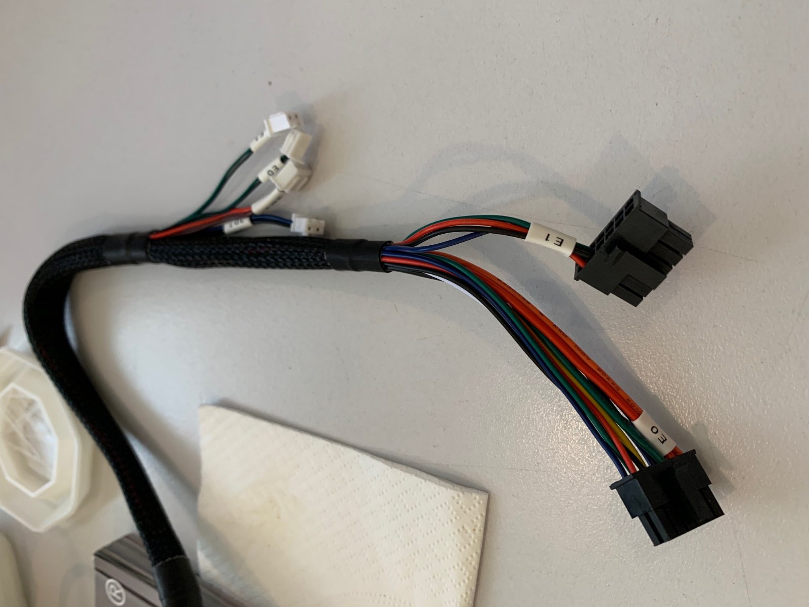

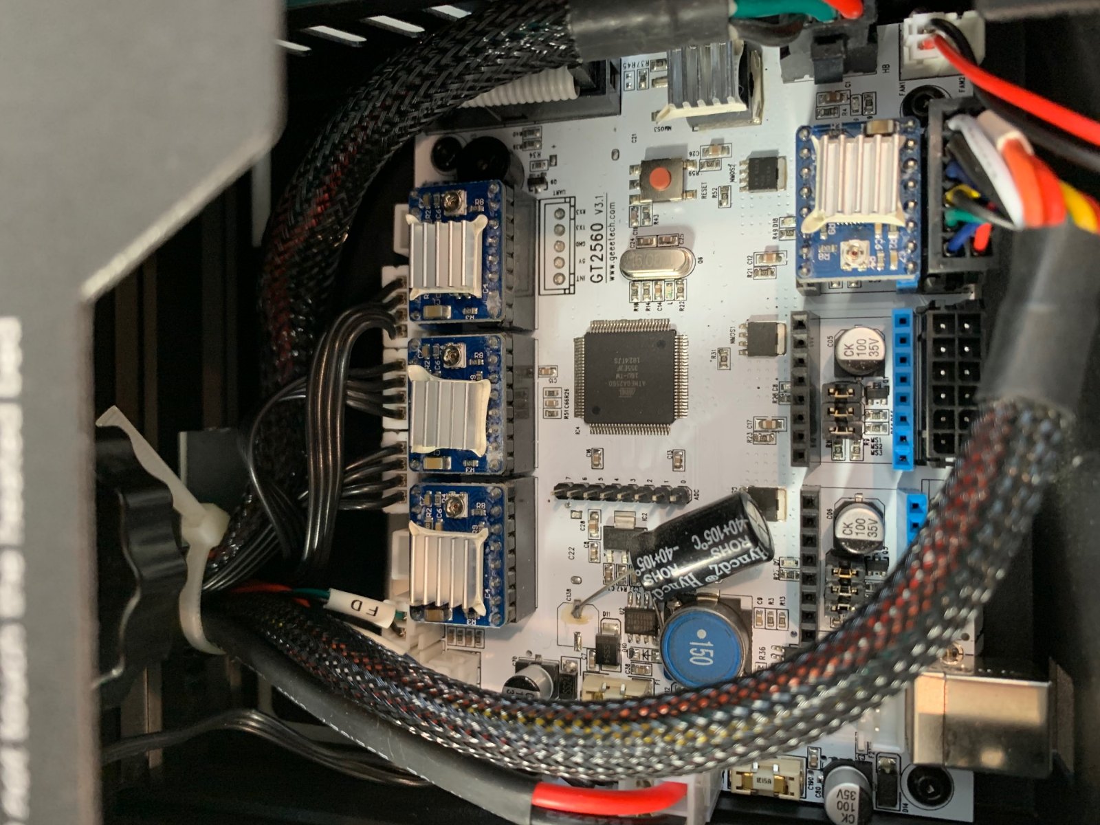

hi, thanks for your reply
I have the V3.1 board, it has the part soldered already
now I have a cable with 4 additional plus I don't know where to connect, there is no wiring diagram...
2 are marked 3DT, 1 has E1 and E0
ALso the part A4988 not sure what to do with it...![Image]()

ok, I found where the 4 plugs were going, in fact I had to remove some with the previous cable and I had not seen it
last problem is the 4988 part which I do not install, maybe it is not needed as I have a more recent board
