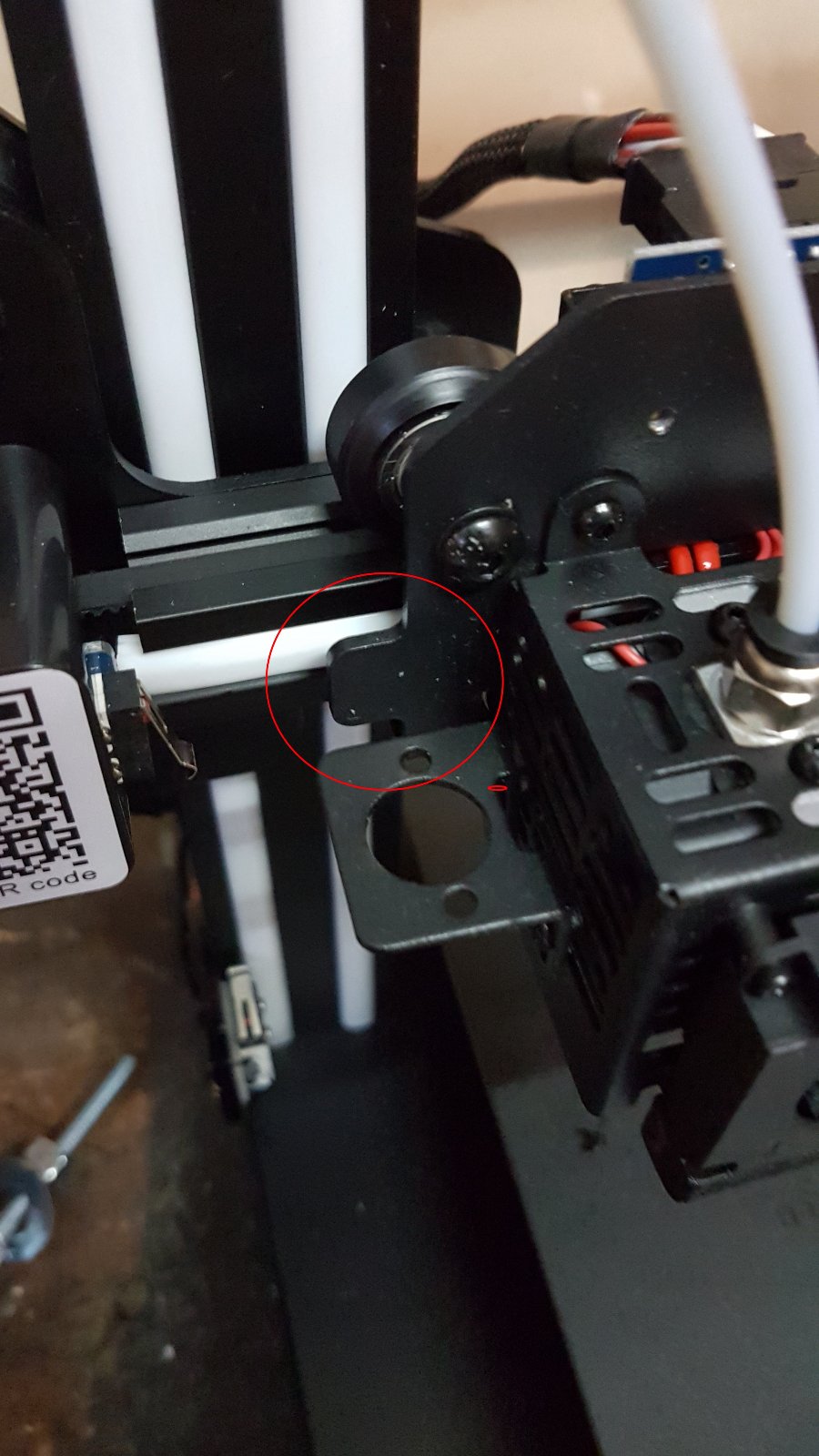

  • The more problematic : The X carriage have an ear, so the hotend doesn't go outside the bed anymore. I can't add a purge bucket for multicolor print.
Is there a spare part to change the carriage ?

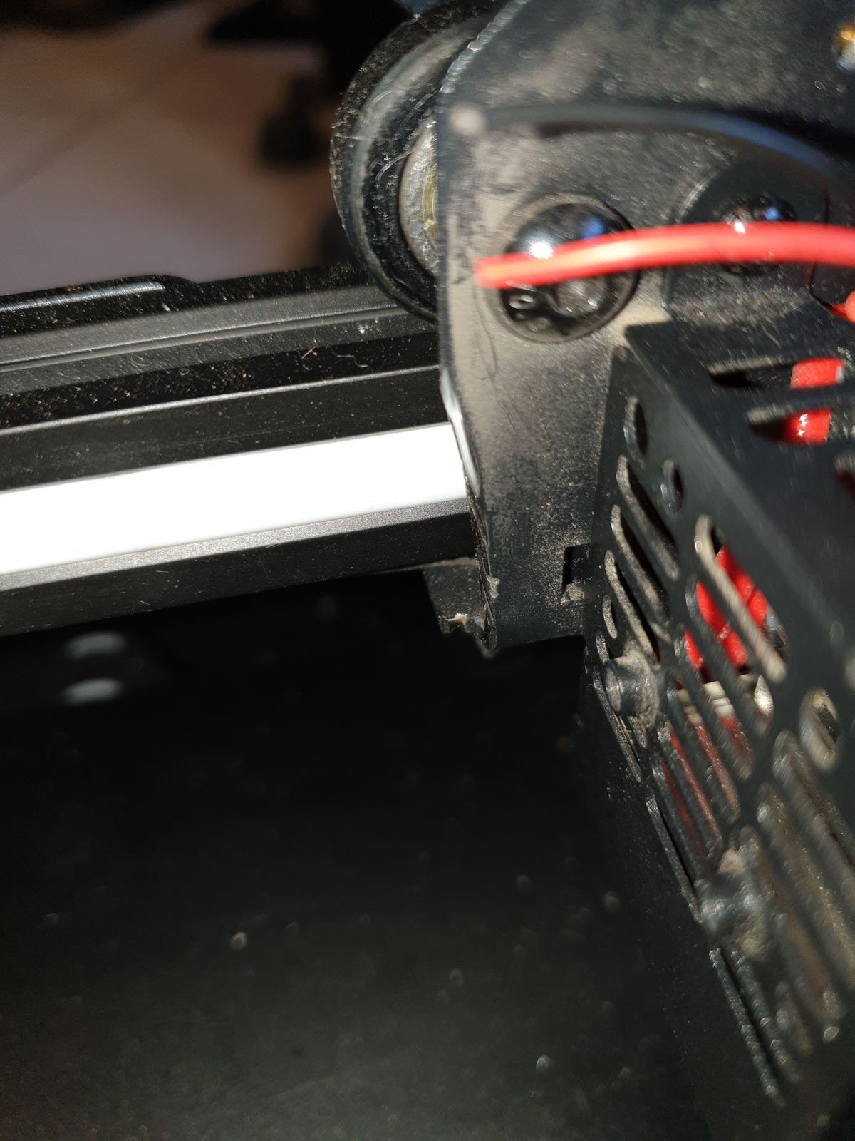

For the purge bucket I simply cut the part that was disabling x carriage to go outside (see picture), you have to be carefull with the x stop, It has worked for me and I am able to use purge bucket now.

For the example of the X "ear", firmware is always reported a -10 mm position at X endstop in official sources, mo mentions of this version in comments.
I'll try to cut 10 mm of the X part.
thanks !
If you dont have have tools to do that, you can maybe simply order a new hotend cover https://fr.aliexpress.com/item/32963363300.html

Thank you for your ansmers, I've finaly cut the piece, all is OK.

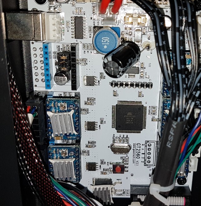

I used to have problems to flash my other printers and decide to open the priter to uplod with my USBAsp adapter.
And surprise, no connectors, it seems to be a new bord, marked as GT2560 v3.1
20191104_220859 (1).jpg (157.04 KiB) Viewed 46523 times
If any of you as an idea or links, let me know !

Hi Vert,
Good idea ! I had install the drivers manually...
I ask windows to auto update driver, reboot and flash is complete with arduino 1.6.8 !
Last question to go further, did someone know wich drivers are installed to my card ?
Regards,
Ju

Where you connect bltouch?
theju
Posts: 14
Joined: Mon Nov 04, 2019 6:03 pm
Re: New A20M Model ?
Post by theju »
psxsnake wrote: Wed Nov 06, 2019 4:34 am I have same model variation.
You have the 5 pins at the top of the small board, just under the big connector
Ju

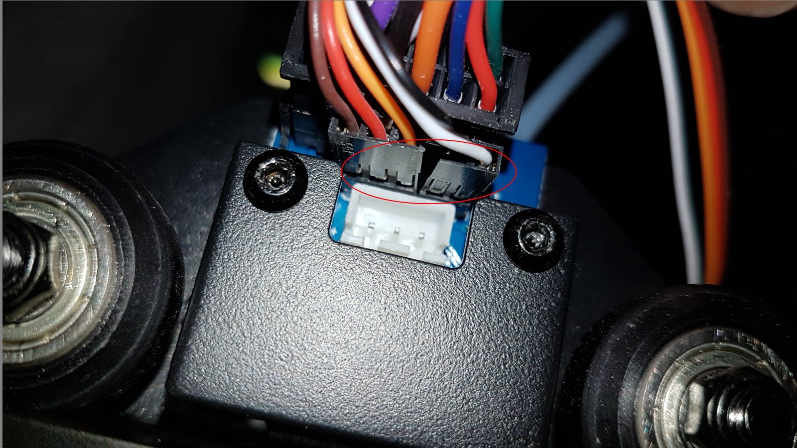

Here the photo much easier to understand.
Does anybody know what is the 3 poles connector under ?
