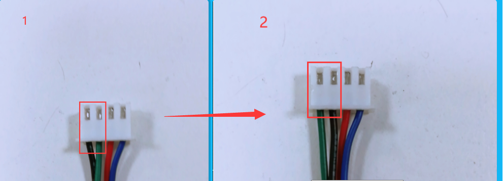

Hi friends, is there A20T firmware with 3D touch and TMC2208 support?
Re: The TMC2208 about A20T Firmware
mlabis wrote: Sun May 03, 2020 3:56 am Hi friends, is there A20T firmware with 3D touch and TMC2208 support?
Hi,we do not have the corresponding firmware, you can directly exchange the wire sequence as shown in the figure.
