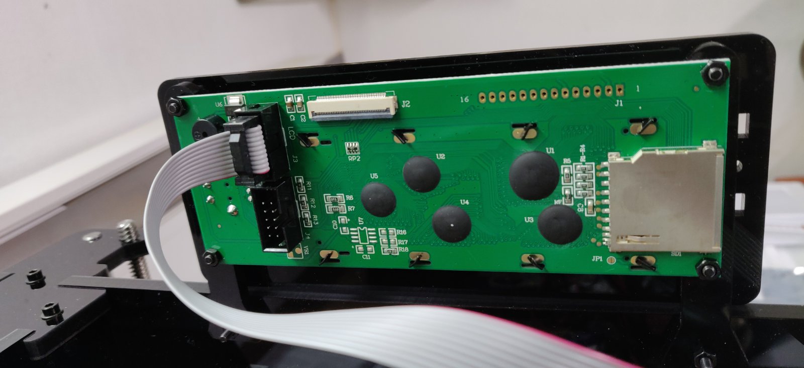

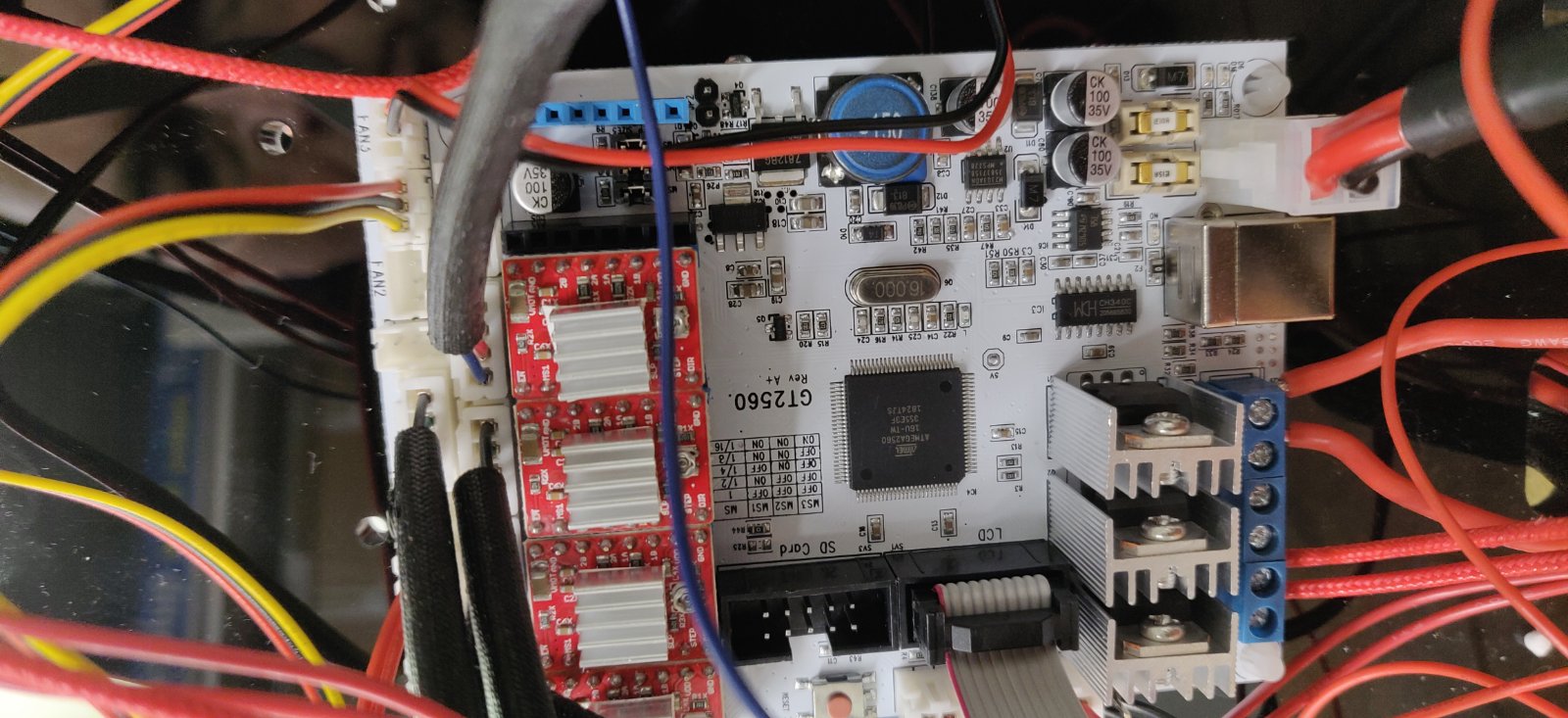

Hello, I've assembled my new I3 Pro B within the last days. After finally switching it on only the fans are working and a green light is on. The LCD display did not show anything. The type of the LCD is different than mentioned in the PDF assebly ionstruction. I've attached two pictures showing assembly of the flat cable on the LCD connector and the controller board.
Not sure if I missed something or maybe used the wrong connector.
Maybe anybody can guide me the right way

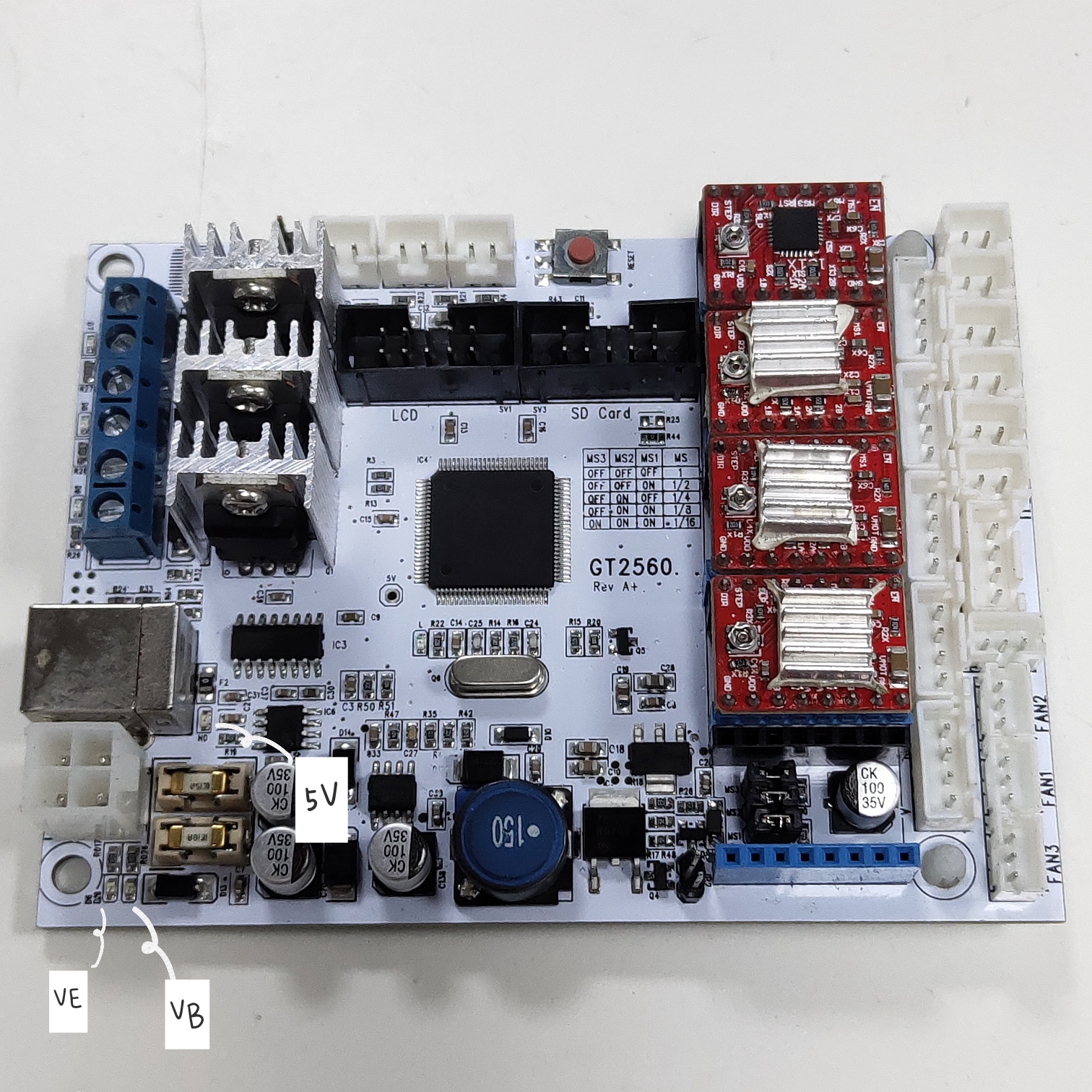

:D Hi, You can check if your screen wiring is reversed.
Adjust the voltage range you need before turning on the printer;
Turn on the printer to see if three lights on the motherboard are on.
You can refer to:
A+ 三灯亮起的位置.jpg (1.43 MiB) Viewed 46058 times

Ve and VB are on, 5V is off.
Do you have a pin layout for the wiring? I checked pin 1 and 2. Looks like Pin 1 is power and Pin 2 is Ground in both connectors. but verifýing would be easier with a proper pin layout.
Reimund
Re: I3 PRO B Display not working
:D Hi, for the schematic you can refer to this: https://www.geeetech.com/download.html?download_id=43
If the 5v light on the motherboard is off, the screen will not light up properly.
