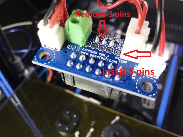

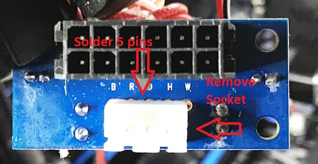

just upgraded from Geeetech I3 ProB to a A30 and a good move. I want to instal a 3D Touch which I thought would be plug and play, but do research it does not seem that straight forward.
To install I need to
1. Remove 3 pin socket and install 5 pins see pic's
Extruder Top.jpg (84.51 KiB) Viewed 7004 times
Extruder bottom.jpg (107.21 KiB) Viewed 7004 times

a, Is this all that is necessary to install the 3D Touch?
b, What way do the wires go on the 5 pins ( Colour left to right )?

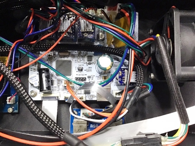

c, What type of board is this - ref image

Hi,Your adapter board is an adapter board for capacitive sensors.
and the new motherboard is GT32 pro vd.
the old is GT32 mini.

So the board will be ok for the touch sensor when I solder the 5 pins in?
Robert
Re: Installing 3D Touch on A30
Hi,You need to use the corresponding adapter board, your adapter board should use capacitive sensors.
