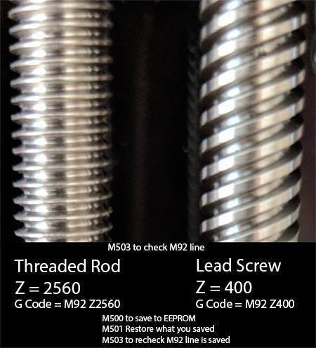

Hi,you can check whether the step vanule corresponds to the value in the picture below.

Thanks - someone on reddit gave the same advice and it worked.
Could the firmware not be updated to correct this?
