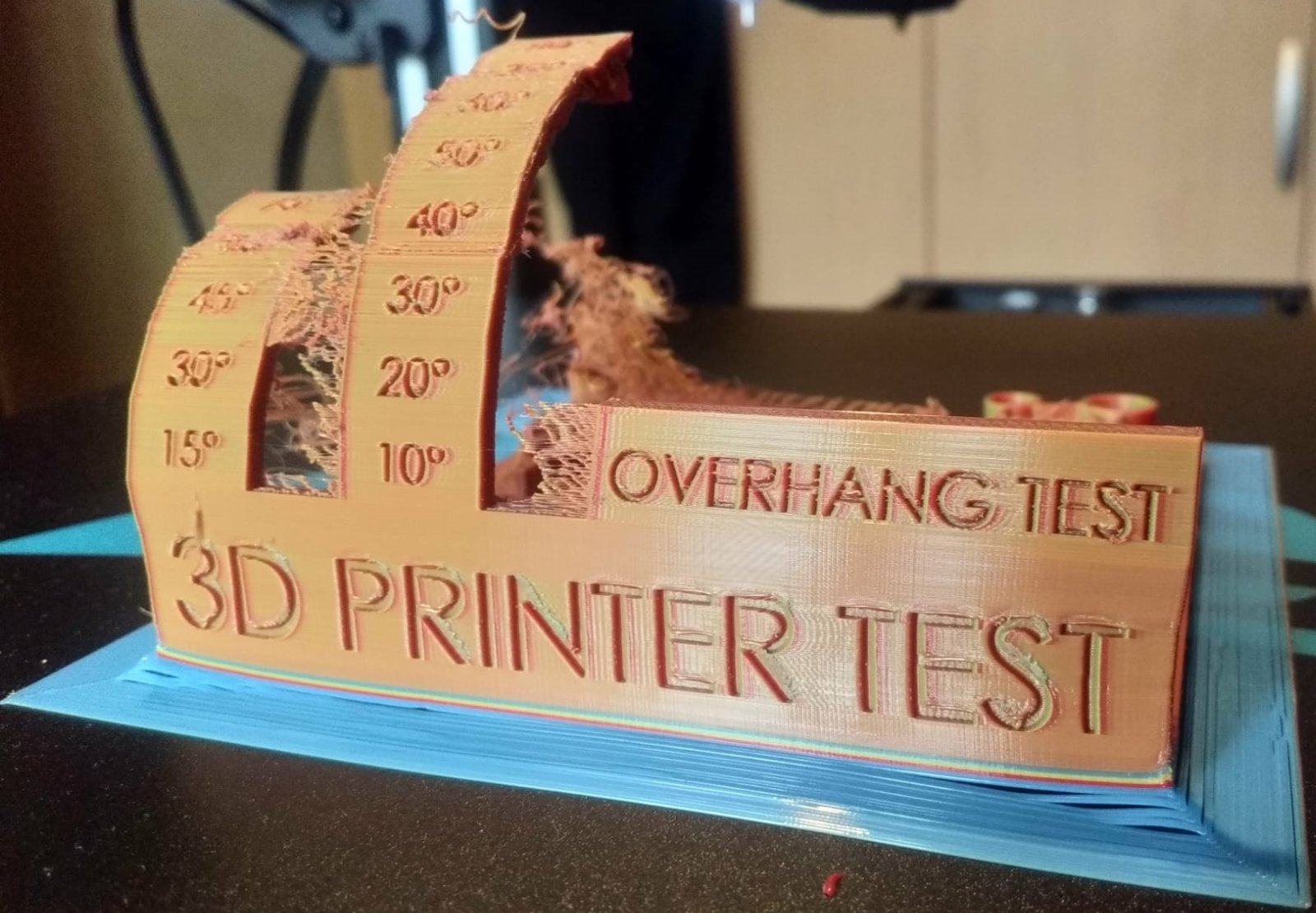

Hi,if your model is brushed, the possible reasons are:
1. The model is too complicated and the model size is too small. You can reduce sharp corners, thin walls and cantilever structural design through model processing
2. Model cooling is not enough. You can increase the wind power of the cooling model fan.
3. With regard to the drawback parameter set by the model, you can adjust the drawback speed and distance (the drawback distance should not exceed 6mm).

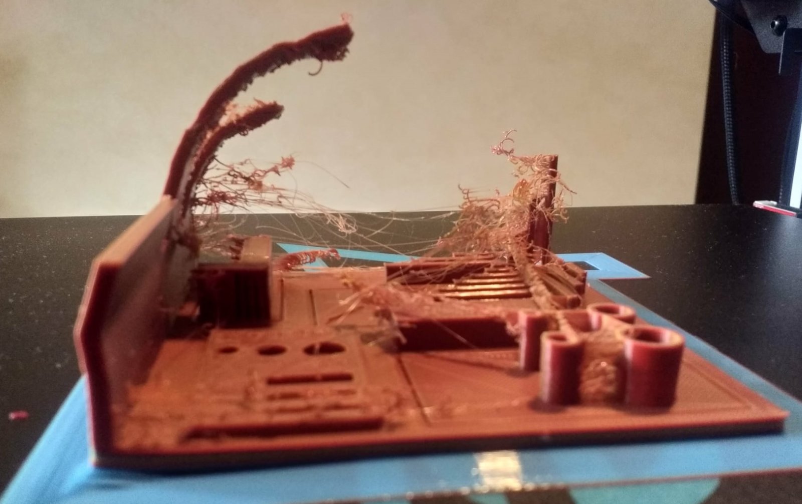

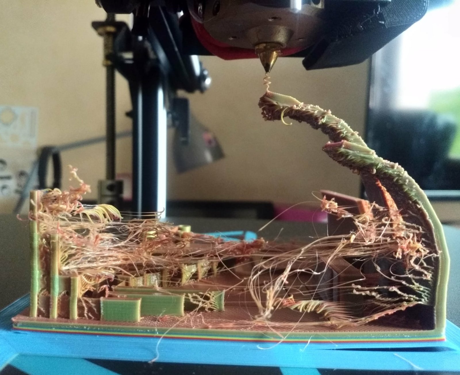

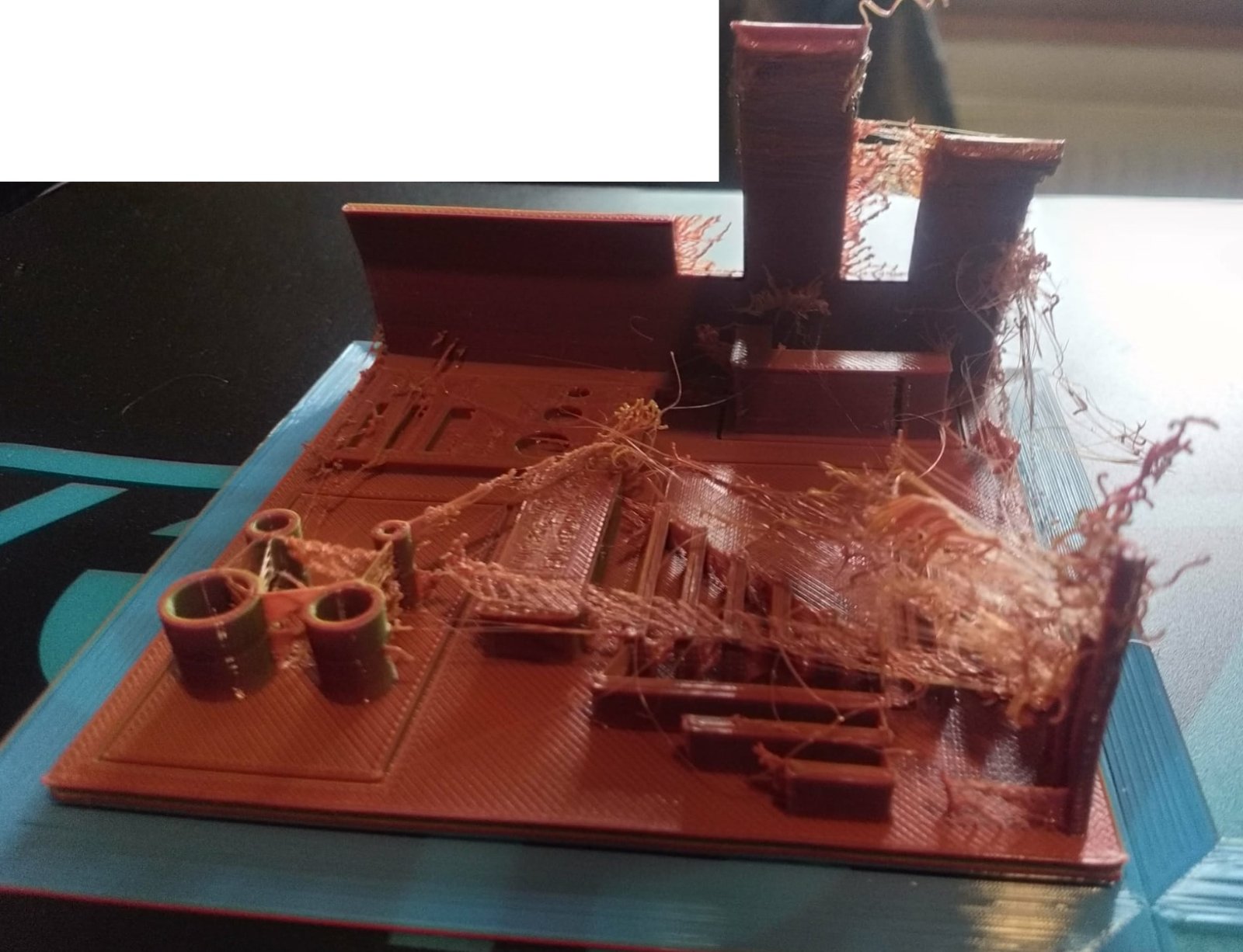

its a stress test
if printer dont print this test a stock here is a big big problem from geeetech conceptor no???
William, do you have a cura profile for this machine?
I contacted all the buyers of the A30T and nobody can make beautiful prints. Everyone has way too many problems.
is it possible that geeetech tests the machine and performs a correction and working profil fora good slicer (cura, prusa slicer)
thanks.

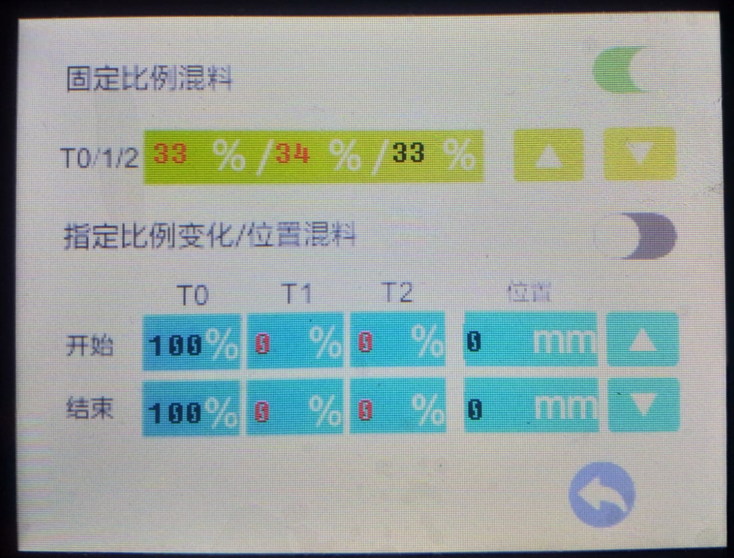

Setting of firmware before and after a reset Image
lcd firmware patched with good translation (PUT IN A SD AND PUT IN SD READER OF LCD and power on) https://app.box.com/s/c9suuy8vrcsq60zw5gsr2y13g9sqwrie
