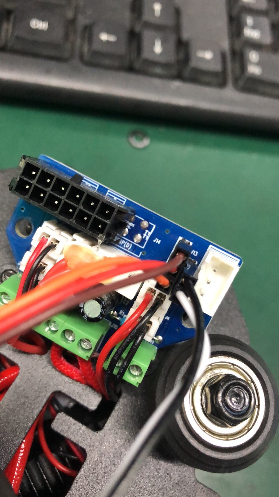

Can you give some indication how correctly plug thez 3 d touch an a A 30 T.

Re: A 30 T & 3 d touch
Hi,this is the connection.

Thank you Wiliam for the picture
my cable was plug like you. So what do I wrong ?
