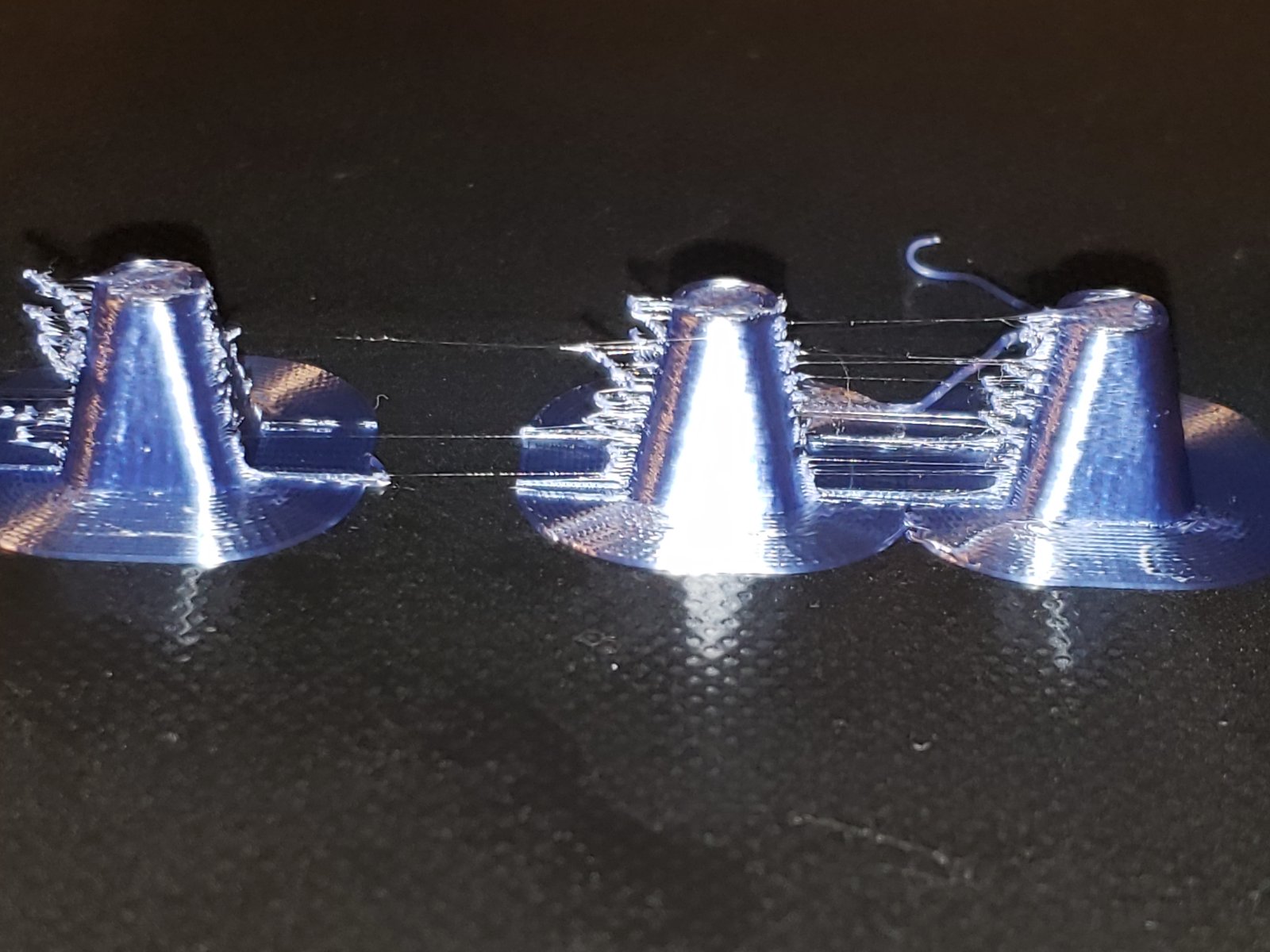

Geeetech A10M with PLA filament
- can't get it to stop stringing
- stringing photo geeetech a10m.jpg (236.29 KiB) Viewed 59006 times
Re: A10M Retraction Settings
Hi, you can adjust your print speed to around 30 and then increase the distance and speed of the drawback.
I believe the small disks are there in order to prevent filament from extruder one to go up the tube for filament 2, and the other way around (at least that is the problem I had). I don't think it is ok to remove them.

How exactly do you remove those discs? do I unscrew them or use a punch?vert wrote: Wed Jul 03, 2019 2:22 amit is true they are intended as anti back flow but it is also true these disks are the direct cause of 100s of other issues and when there removed there are zero noted draw backs.mattgtr wrote: Sun Jun 30, 2019 5:38 am I believe the small disks are there in order to prevent filament from extruder one to go up the tube for filament 2, and the other way around (at least that is the problem I had). I don't think it is ok to remove them.
they need to stop putting these disks in at the factory they are self sabotaging there own products with them.
many of my discord users have done this and all of there issues went away and had no issues since its been many months since they did this.

This looks pretty good Naciron. You said "default retraction settings" - can you give the actual numbers that you used? I'm guessing this is PLA. Thanks!naciron wrote: Fri May 17, 2019 5:35 am Before and after the stringing tweaks (discs removed, default retraction settings, higher travel speed 200mm/s, lower temperature 190 degree for my material)
Default is 6.5/40mm if you have calibrated E-steps in firmware.
I have it in factory settings by many reasons, but measured multiplier is 1.31, used 1.23 to 1.29 (by print speed).
A10 Slic3r profile: here
If you do not, you must change this setting in the firmware. Mine was limited to 25mm/sec regardless of what my slicer settings were. Updated to Marlin 2.0.1 and removed such limitations with extremely successful results.Jarda3d wrote: Sat Oct 19, 2019 8:08 pm Default is 6.5/40mm if you have calibrated E-steps in firmware.
