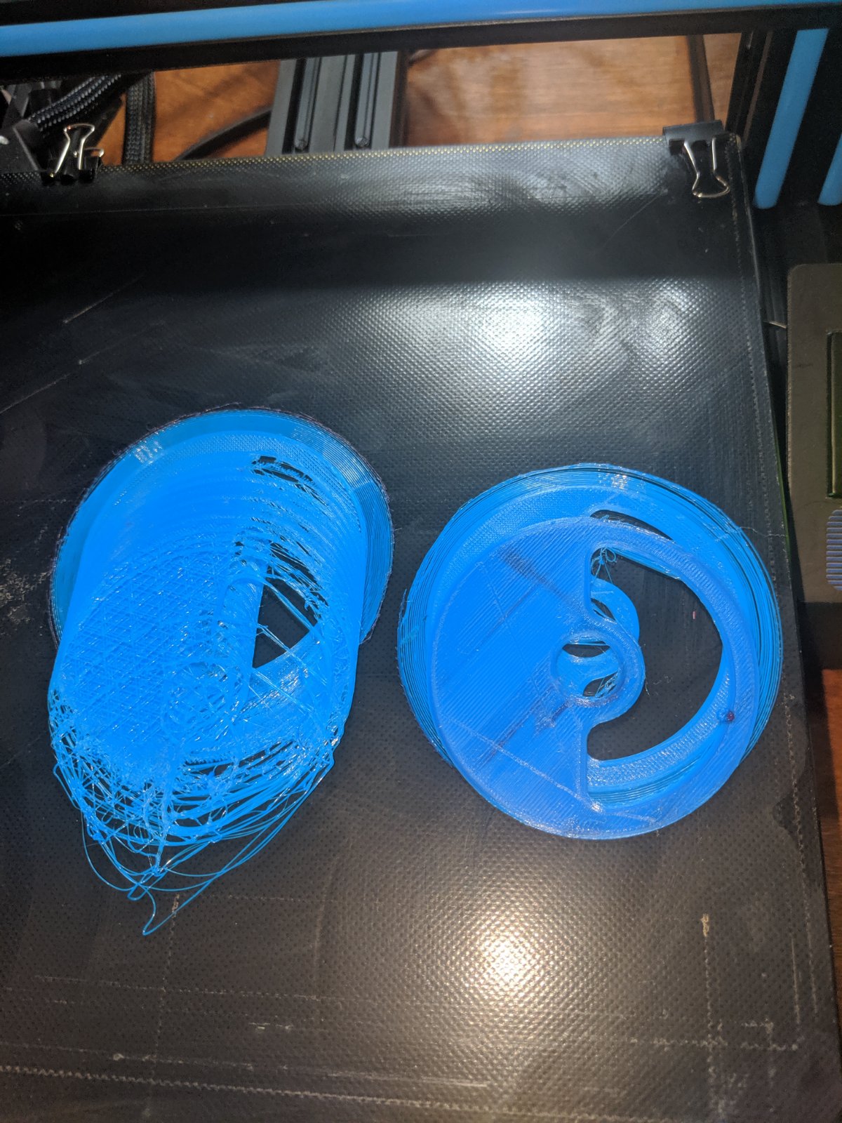

Is this something loose or y axis step is off. Or something else? How do I fix?
The dog came out perfect. Everything else drifts forward. Great bed adhesion.
Print drifts
Print drifts

Hi, Hi, You can do the following checks
1. Check the tightness of each shaft and make appropriate adjustments.
For details, please refer to this:
https://www.youtube.com/watch?v=QmrT1sPhvf8
https://www.youtube.com/watch?v=ZoOaT5fkgfg
2. Check whether the bearing and the pulley are issued (the card can be lubricated for lubrication);
3. Appropriately reduce the printing speed, the reference range is 30-60mm / s.
I hope this can help you.
