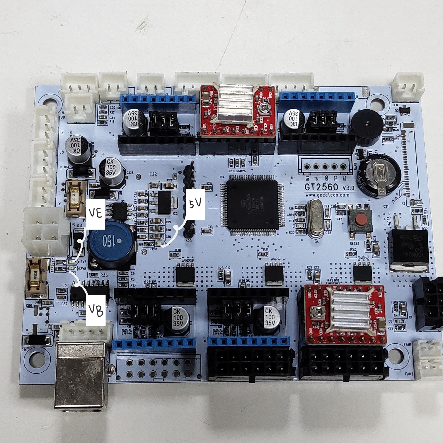

Hi, Can you provide specific pictures?
When the printer is turned on normally, the three lights on the motherboard are normally on.
you can refer to this:

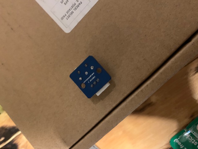

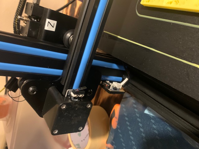

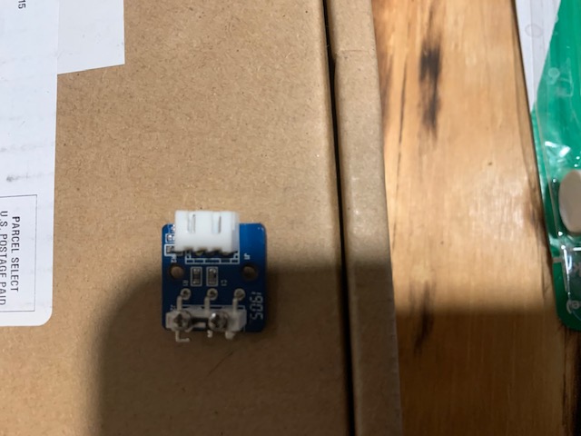

Got it (smile)I had replaced the Micro switch (stop Switch) with generic switch. no LED on Switch. Removed 5 volt power wire from switch plug, was shorting out power. My printer is up and running and has printed a test Dog came out great. Where do I get the factory stop switch's looking for 2 506l one is working LED out the other works but not factory also no LED Thank you.

First pics of stop switch temp fix? last 2 are of old stop switch I'm looking for 2 of.
