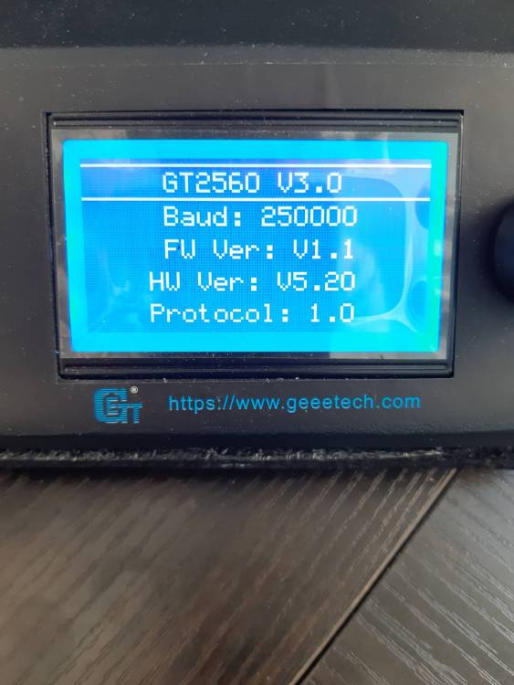

J'ai une A20M avec une carte GT2560 V3
As-tu pu résoudre ton problème ?

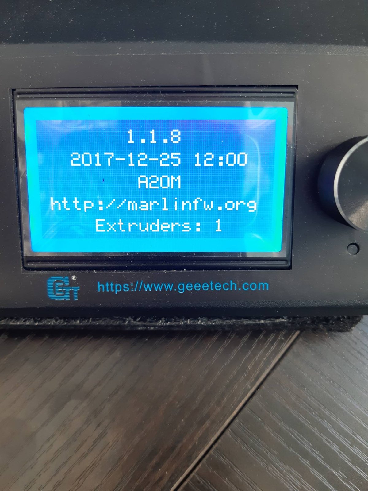

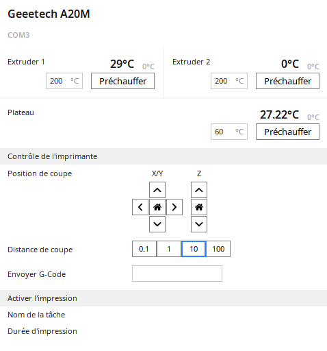

Armaguidon34
Posts: 2
Joined: Wed May 27, 2020 12:55 am
Re: Problème extrudeuse E1
Post by Armaguidon34 »
Hello
Thx for your answer
Yes I have selected the correct model in Cura Software.
But with or without slicing software, it is not possible to access E1 within the printer menu "Move axis". Only E0 is available.
It is exactly like only one extruder is saw by the firmware.
Please see the attached picture
Menu under Cura
Menu under Cura
