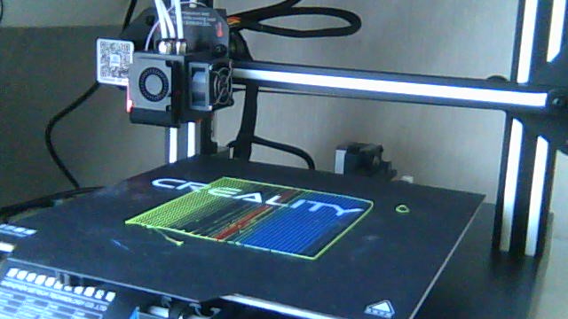

Re: head extruder a20t not working good
Hi, Can you provide print pictures or videos?
i did make a little testprint with change the 3 colors its with original geeetech firmware only its a magnetic bed of creality

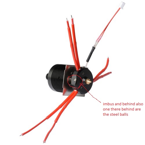

I have the same issue but I don't understand what you mean. Could you post a picture of these "steel balls" please?
andrevanderweide
- Posts: 14
- Joined: Sun Dec 08, 2019 2:28 am
- Location: almere Netherlands
there for every filament tree imbus with behind a second imbus and there behind are the steelballs
- Geeetech_headbal.jpg (32.7 KiB) Viewed 13538 times

Re: [solved][Opgelost]head extruder a20t not working good
Thank you for your reply.
I understand that what you call "imbus" is what I would call hex screw / Allen screw in my country.
I tried to unscrew the 1st "imbus", but I did not manage to make it turn at all.
I used the key provided by Geeetech. It seems to fit just right in it, but when I turn it slips inside. I feel that I am damaging the "imbus".
make the head hot with hair dryer or paint burner when you have the rest removed
sometimes then the get lose
