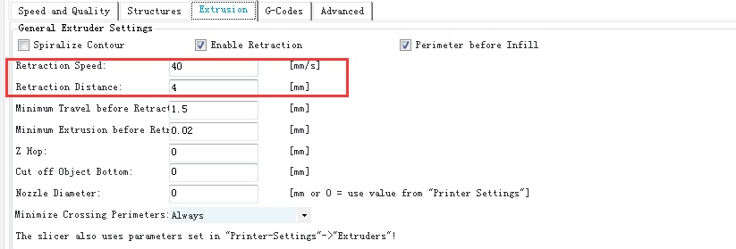

It is recommended that you set the parameters as shown
- 6.jpg (53.22 KiB) Viewed 5449 times

The above picture is the parameter setting of repeter-host. If you are using Cura, you can download the Cura file of A10m at the link below and import it.There are detailed import steps in the downloaded file.By the way,the retraction setting of cura is shown in the figure.
