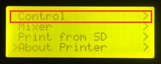

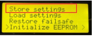

Re: default mix setting for A10M
Hello, you need to save the settings in the interface shown in the figure below every time you change the printer settings.
