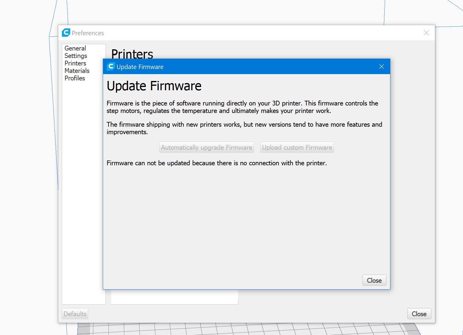

while flashing via cura my pc got a Bluescreen and now the printerdisplay shows only [][][][][][][][][]
my pc shows the printer as COMport4 as it should be, but cura says that there is no connection

flashing with cura doesn´t work anymore, it says there is no Connection to the printer

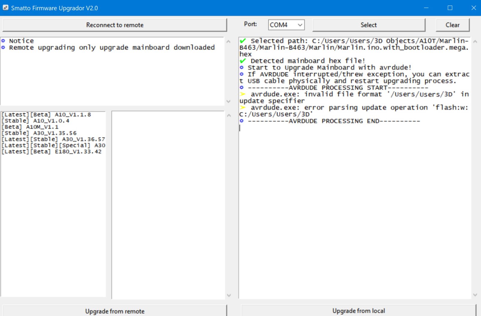

with firmwareupgradetool AVR says invalid file format
what am i doing wrong?
@vert how do I know at what moment i have to press reset?

thank you, but I already saw this Video
my Problem was, that in the path (where the new Firmware was) had a space in a foldername :oops:
so I changed the foldername and now AVRDude starts, but now AVRDude gets a timeout :/
i turn on the Printer, wait about a Minute, then start the firmwareupgradetool, select the correct COMport and the .hex with the Bootloader ( I tried the .hex without Bootloader also) press and hold the resetbutton on the Display and hit Upgrade from local while releasing the button.
now this ERROR appears
avrdude: stk500v2_ReceiveMessage(): timeout
