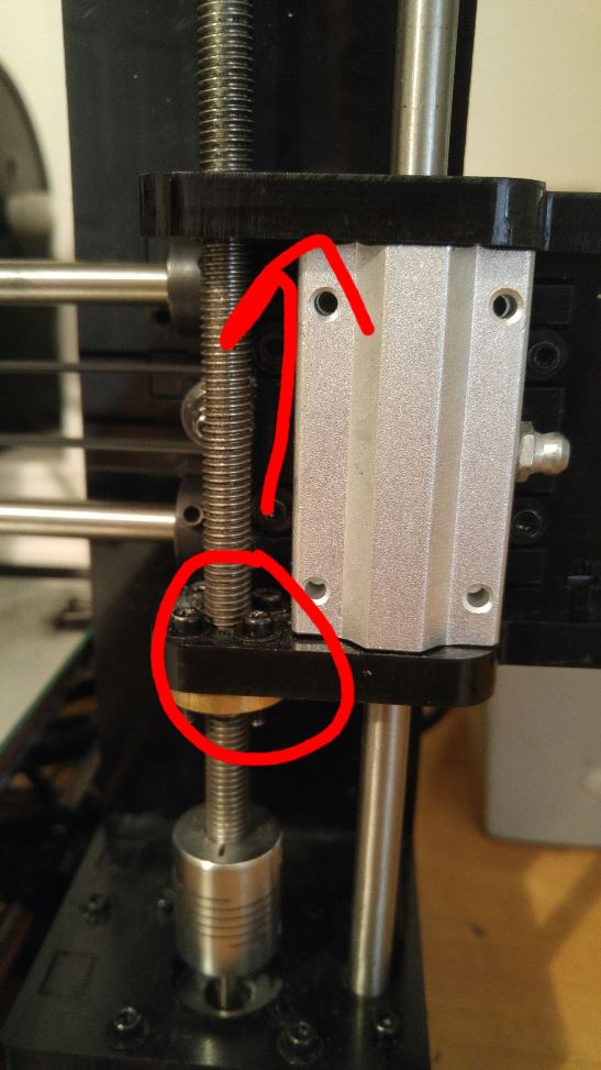

The right side of the X axis assembly....place the brass threaded piece at the top of the bracket...not the bottom where they show you..it will improve your quality and there is holes for it already...if you find a way to do the left side...do it also
Move this up
Move this up

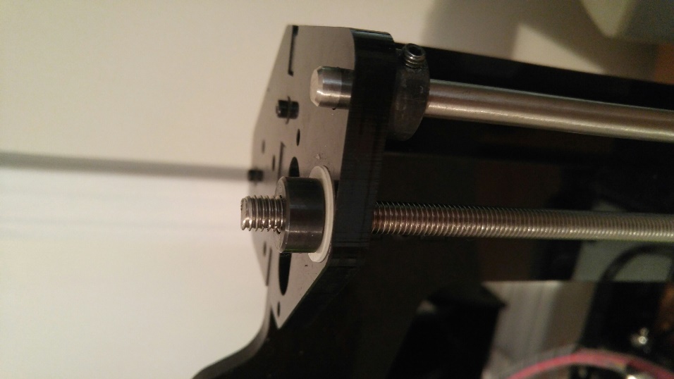

I went to Ace Hardware and purchased 2 lock rings...like the ones on the Z axis smooth rod, also bought 4 nylon washers....place them on the threaded rods but above the top frame piece so the 2 washers are on the frame and the lock ring sets on them...lock it on the ring so it takes all the weight off the Z axis motors...then finish assembly as directed below...
Z rod support
Z rod support

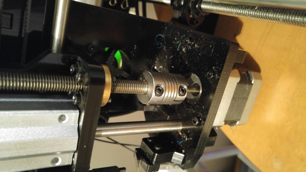

Do not try to use the flat side of the Z axis motor shaft and the flex coupler...it will never line up....take time here to get the coupler to spin with NO WOBBLE...loosen it..turn it some and try it...do it over and over until you find when it is connected to the threaded rod it does not wobble..I had to file the threaded rod slightly where it goes into the coupler....spend some time here and get it straight...NO WOBBLE..
coupler 1k.jpg Also....dont bother the 3d printers store with to many questions...after about 5 emails they have stopped responding...I was missing parts and also requesting cad files for broken acrylic parts...got them but have not been able to get spare parts from them....must have bothered them to much My prints are coming out nice now.... [attachment=0]1229151046a_resized.jpg
Coupler on Z axis...take time to get no wobble in it
coupler 1k.jpg (174.33 KiB) Viewed 73803 times

I found that replacing the flexible shaft couplers with rigid ones eliminated banding (one extra wide layer due to shorter Z-travel about every 7 layers) that was caused by the flexible couplers compressing due to bent rods.
