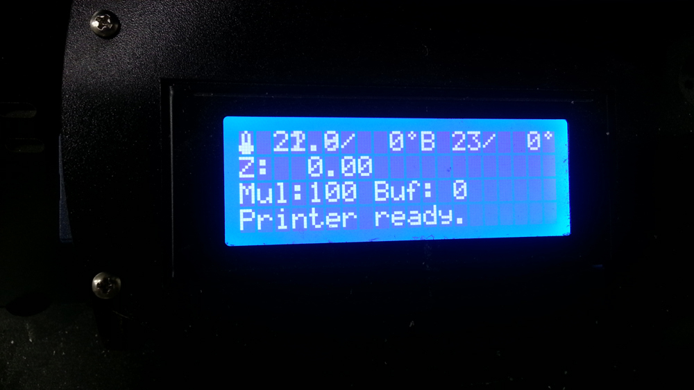

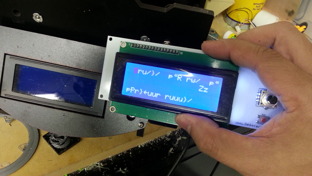

can you help me with the below issue?
I've attached 2 pictures, one of an existing, working LCD controller I already have, and one picture of what I get when I remove that one and install yours (LCD 2004 display controller)
I have an existing Rambo 3d printer with a very similar display that is working correctly. When I try connecting your display to that printer, the backlight, knob, and buttons work, but the text is not displaying correctly, I cannot read it, please compare the pictures. Help please? Is there some further documentation for your display that I could have? Thank you!

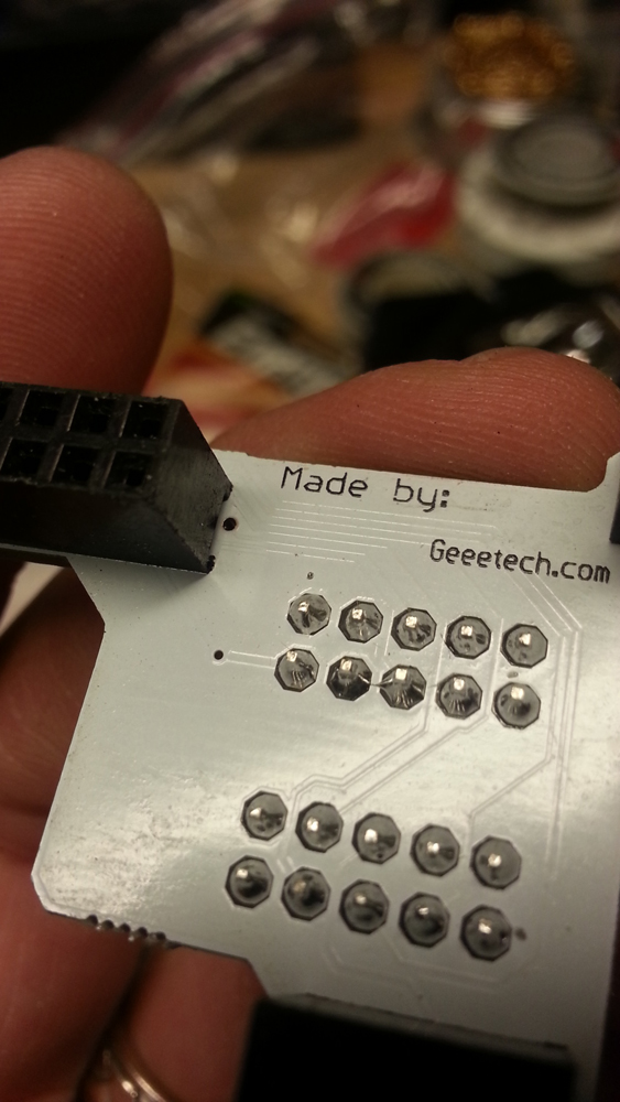

The whole set of wiring was done by GeeeTech, as I also ordered your pre-assembled Rambo LCD adapter.
Luckily for me I had another working LCD controller to test against, and I found that the problem was one of QC (quality control) on GeeeTech's part.
See the picture attached below. Look carefully and you'll notice that there is a messy solder joint that is shorting across two pins on the back of GeeeTech's Rambo adapter:
Once I cleanup up that mess, it is now working perfectly. I can't tell you how many hours I wasted messing with firmware when the issue was the hardware all along. Why would I suspect the wiring when all of it was pre-assembled?
