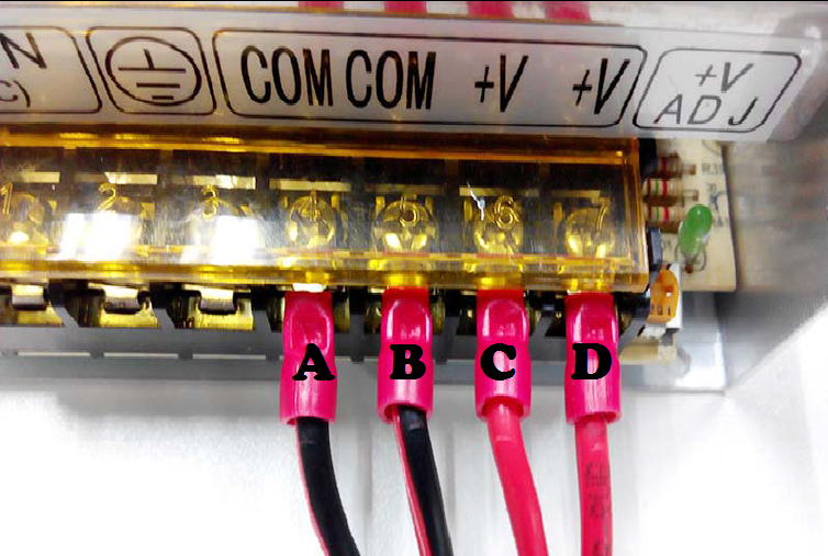

This is how i measured the voltage, i didnt take a photo because this is easier to explain how i did it, also remember ....the voltage from the fan output on the board is the same (3.3v) so i am thinking there is definitely something wrong with the PSU.....what do you think
Voltage using wires(A and C)or (A and D),(B and C) or (B and D)
Measuring voltage.png (632.16 KiB) Viewed 8847 times

Test the DC voltage between A and C, the DC voltage between B and D. They should always be 12 V.

Well that's what I did, the DC voltage is always 3.3 v

Post by zhangxueyou »
Sorry for replying so late because of power outage.
Yes, the issue exists in power supply.
You can buy another brands of PSU, but there must be 2 groups of 12V output voltage, and the current should be more than 20A.
