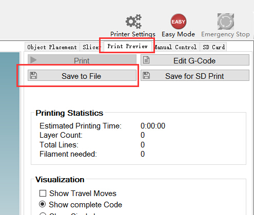

If you use repetier 1.5.6, you can slice the object with slic3r, and generate the .gcode file for SD card printing here:
"How do I center the prints on my G2s ... "
and how do you set your printer setttings?
