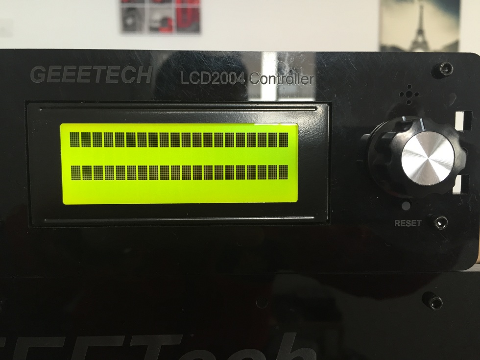

One month ago, I bought a 3D Printer geeetech I3 Pro. At first, the printer it worked perfectly. But two days ago the printer not work, there are a fail in LCD2004, no there are letters, only black squares.

fail printer i3 pro

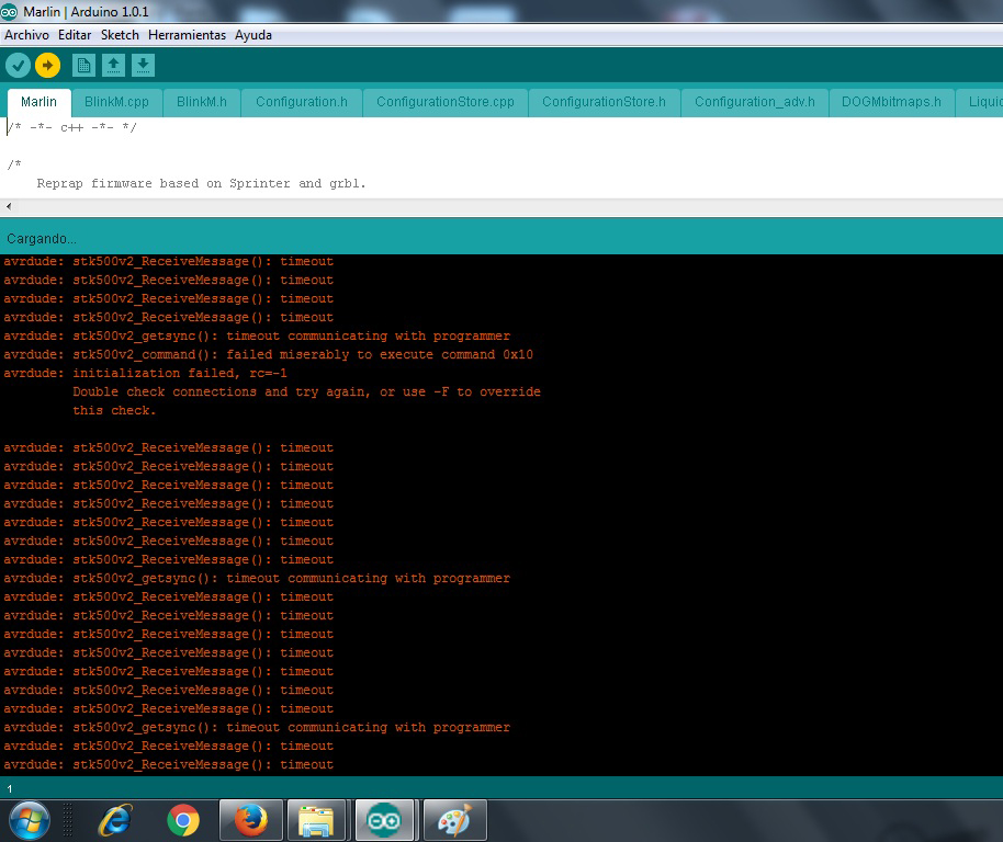

I've tried various options. I've tried load the firmware, but i had a problem in Arduino, i've loaded the images with the problem.

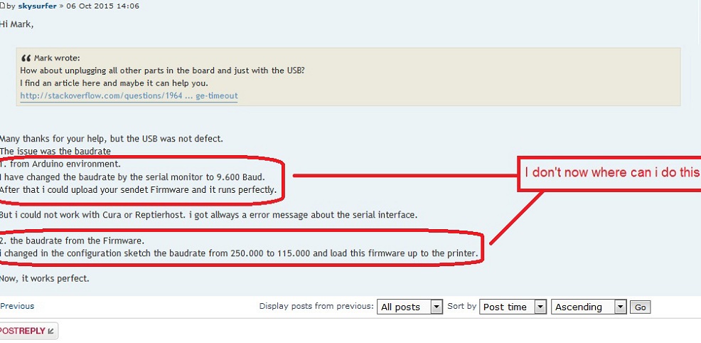

In this link ( http://www.geeetech.com/forum/viewtopic ... 23&t=16288 ) there are a persons whith the same problem. They say "The issue was the baudrate
1. from Arduino environment.
I have changed the baudrate by the serial monitor to 9.600 Baud.
After that i could upload your sendet Firmware and it runs perfectly.
But i could not work with Cura or Reptierhost. i got allways a error message about the serial interface.
2. the baudrate from the Firmware.
i changed in the configuration sketch the baudrate from 250.000 to 115.000 and load this firmware up to the printer.
Now, it works perfect.", but i don't understanad this. I've loaded a image of this too.

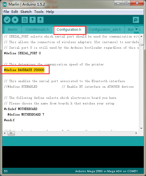

- This is the solution in the other link
- 4.jpg (121.03 KiB) Viewed 9786 times

Re: fail printer i3 pro
you can change the baud rate as the pictures shows:

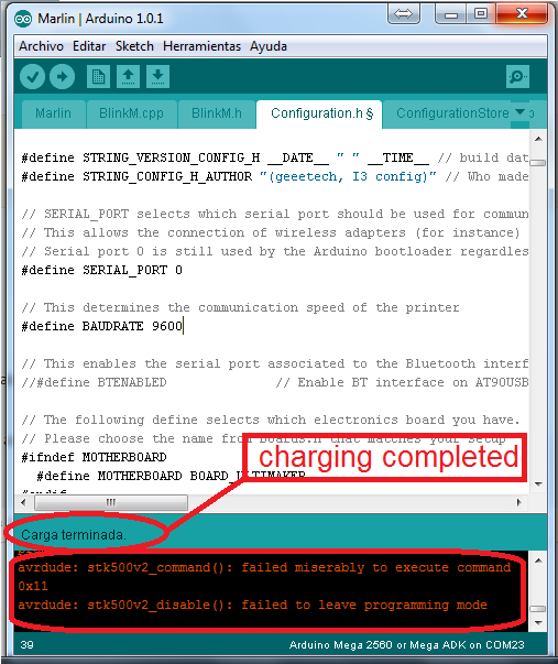

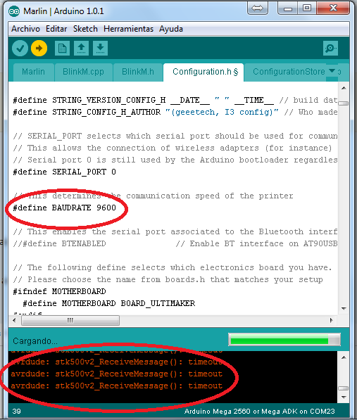

I've tried change baud rate by the serial monitor to 9.600 Baud, like in the other link, but my printer continues with de same problem
I've loaded two images with the problem.

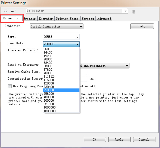

But remember the baud rate in the firmware and in the printer settings should be the same.
