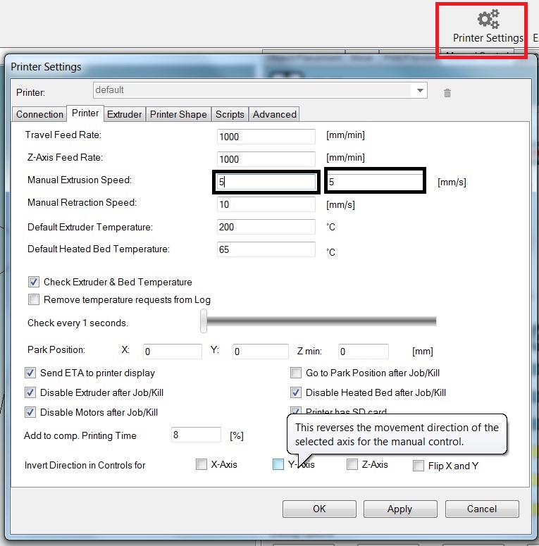

I am using Pro C dual extruder with Repetier-Host. I have problem with manual extrusion rate. Even though I have put the same manual extrusion speed but when tries with both extruders I find that, extruder 1 is much faster than extruder 2. I mean, the rpm of first extruder is much (nearly double) than second extruding motor. But they should be at same speed if I use same manual extrusion speed. right? Please have a look on attached photo, Printer settings > Manual Extrusion Speed > 5 mm/s. I am also confused why there are two fields? Are they for two extruders? first field is for extruder 1 and second is for extruder 2? is it? Please clarify me. Thank you so much for your time and efforts.

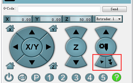

I think the first one is for the normal extrude speed and the second one is for the fast extrude speed:
The speed for the two extruders are the same, maybe you need to check the jumper caps under the extruder connectors, are they the same?

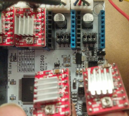

Thanks Mark, I bought the system directly from Geeetech and thew board came as assembled (jumper caps, A4988 etc.). So, I didn't check those. Just now I checked and took the photo of jumper caps of both extruders. Could you please have a look on it and comment if the jumper caps are okay or not? I see, they are little different. Thanks again.

using 1/16 microstepping with 4988, they should be all plugged in, so the jumper caps are correct. Then I think you need to check two things:1) swap the two drivers of the two extruders, see if the speed will change between them too. If so then one of the driver might be defective. 2) check the pads under the driver connectors, see if there's some bad contact or solderings. Or the jumper caps, could they have a bad contact?

Hello Mark, I have figured it out. The problem with jumper caps. I changed with different motors, drivers and found that the problem remains. Then I unplugged jumper caps from X and Y, and plugged in Extruder 1 & 2 then found they have now same speed. Great. Now, I need to replace the problematic jumper caps. Would you please suggest me if Geeetech sells them?
