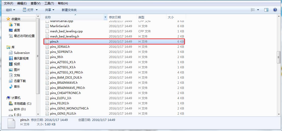

1.Open you firmware file,and find "pins.h",then open the file with your WordPad on your PC:

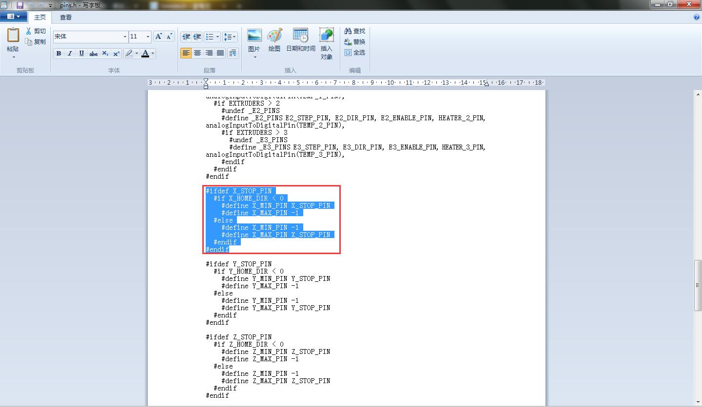

2.Then modify the codes of red area like the following shows:
#ifdef Z_STOP_PIN
#if Z_HOME_DIR < 0
#define Z_MIN_PIN Z_STOP_PIN
#define Z_MAX_PIN -1
#else
#define Z_MIN_PIN -1
#define Z_MAX_PIN Z_STOP_PIN
#endif
#endif
#ifdef DISABLE_MAX_ENDSTOPS
#undef X_MAX_PIN
#undef Y_MAX_PIN
#undef Z_MAX_PIN
#define X_MAX_PIN -1
#define Y_MAX_PIN -1
#endif
#ifdef DISABLE_MIN_ENDSTOPS
#undef X_MIN_PIN
#undef Y_MIN_PIN
#undef Z_MIN_PIN
#define X_MIN_PIN -1
#define Y_MIN_PIN -1
#endif
to this:
#ifdef Z_STOP_PIN
#if Z_HOME_DIR < 0
#defineZ_MIN_PIN -1
#else
#endif
#endif
#undef X_MAX_PIN
#undef Y_MAX_PIN
#undef Z_MAX_PIN -1
#define Z_MAX_PIN
#endif
#undef X_MIN_PIN
#undef Y_MIN_PIN
#undef Z_MIN_PIN
#define Z_MIN_PIN
#endif
You can have a try.
