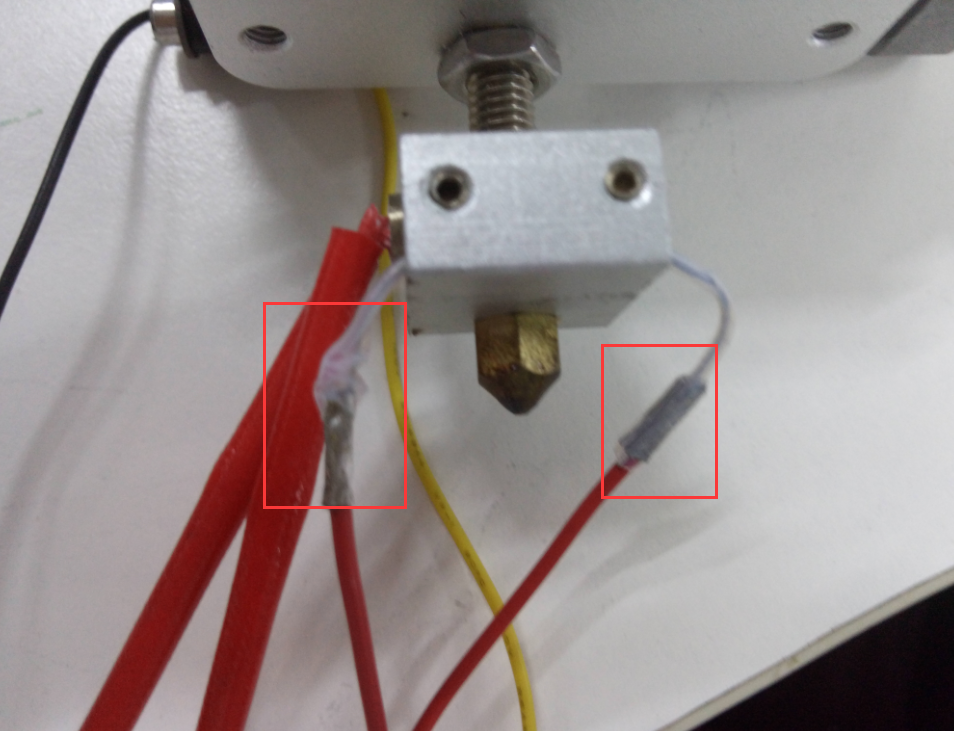

You need to check this part, in most cases the connection problem of thermistor is due to the poor contact here

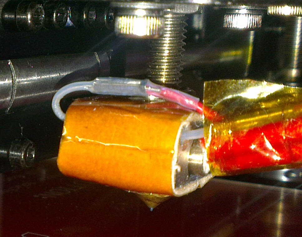

Indeed, the problem seem to be that : when I move the part, the contact is done.
How can I repair this ? I don't try to disassemble this, I wait your advice.
Thanks for your help.
