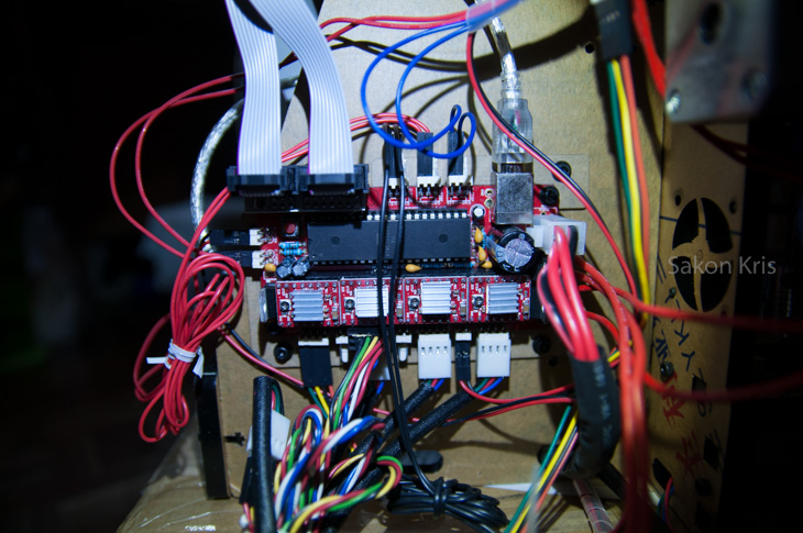

You can find the customer service on website where you bought your printer.
How is the wiring? Could you please take a picture of mainboard?

Wiring.
Wiring
Wiring

Please mount the fan beside mainboard. It is very important for cooling the MOSFET.
Please contact the customer service.

For the fan, the fan's wire are easily broken. I'm finding a new one to replace.
For the extruder, now I power the system with computer's PSU. It can heat up the extruder over 240c, no problem anymore.
Thank you very much for your help.
