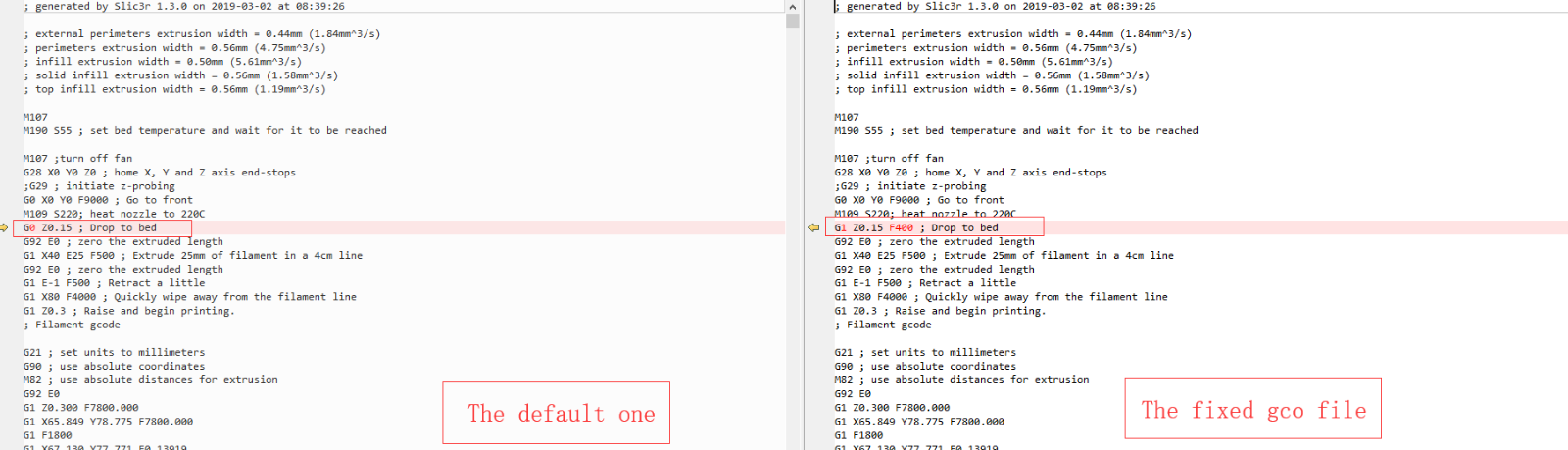

I've fixed it.
I tried to replaced the "G0 Z0.15" to "G1 Z0.15 F400" then it worked.
You can refer to it:
I've fixed it.

So you have analysed the G code and fixed it. BUT that means the GeeeTech Color Mixing Software is faulty. Correct? LOL
Re: GeeeTech Color Mixing Software does not change the G Code
Completely correct!
It is a bug of the color-mixer.
I will talk it with the author.
Thx for your feedback!
