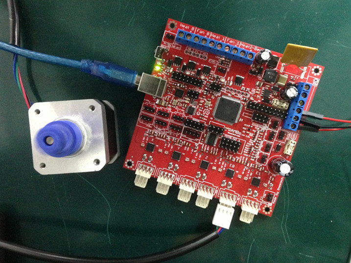

I am sorry,i am unfamiliar with Repetier Firmware.The firmware i am using is Marlin.But i can send a firmware for you to test the stepper motor on your X,Y ,Z , E0 and E1 axis.With this firmware,your stepper motor will rotate clockwise and counterclockwise alternative.

I want to know whether you connect any other external circuitry or not when you use the firmware named rambo.I suggest you connecting the board just as my picture shows. And do you mean that both the E0 and E1 steppers don't work in your last reply?
